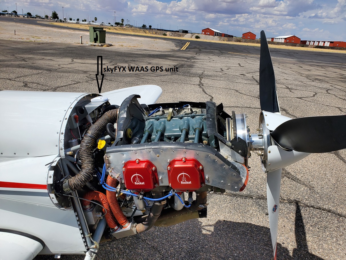

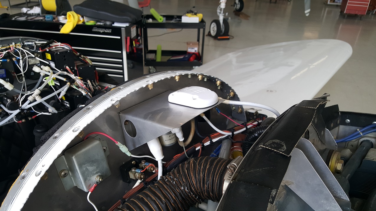

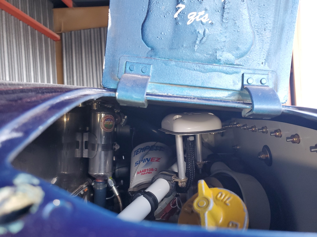

I have installed 3 uAvionix Echo UAT systems in RV's. In all three I used the external combination skyFYX-EXT GPS/Antenna unit mounted under the top cowling. Two at the firewall on a shelf and one on an engine mount. If you go with the under-the-cowl option for the GPS unit keep the it away from any high seat source. In all instances Echo was paired with a digital Garmin GTX 327 Mode C transponder in wireless sense mode, not direct wired with the Mux cable option. I have never had any issue with the wireless sensing. Here are some photos. First two are of my RV-3B and third one is an RV-7A:
