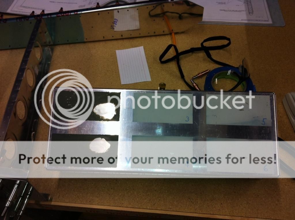

Well, I have finally had time to work with the Eastwood 2k Primer. I am beginning the toolbox kit and practice kit. I primed the bottom of the tool box with various test patches. See picture.
1&2 are Duplicolor Self Etching primer. 1 is applied after using Eastwood pre paint prep. 2 was the same but also scuffed using scotchbrite pad and soap/water cleaning.
3&4 are Eastwood 2k Epoxy primer. Same options as 1&2 above.
5&6 are Eastwood 2k Epoxy primer sprayed 24 hours after activating. Same prep options as 1&2.
The Eastwood primer sprayed very well. Great nozzle that can be adjusted wide or narrow.
I plan on now building the tool box and see how the various samples hold up to the abuse of construction. I have also primed the sample wing section project with both duplicolor and eastwood and will see how it holds up also.

Primer Test
I completed the tool box mentioned in the previous post. The test patches of primer received some scratches. The worst was the Duplicolor that was not scuffed prior to application (1). The best was the Eastwood epoxy that was scuffed with the scotchbrite pad and sprayed right after activation (4). The differences were not huge, but the epoxy did look the best. I could, however, scratch all the test patches down to the metal if I tried with a nail.

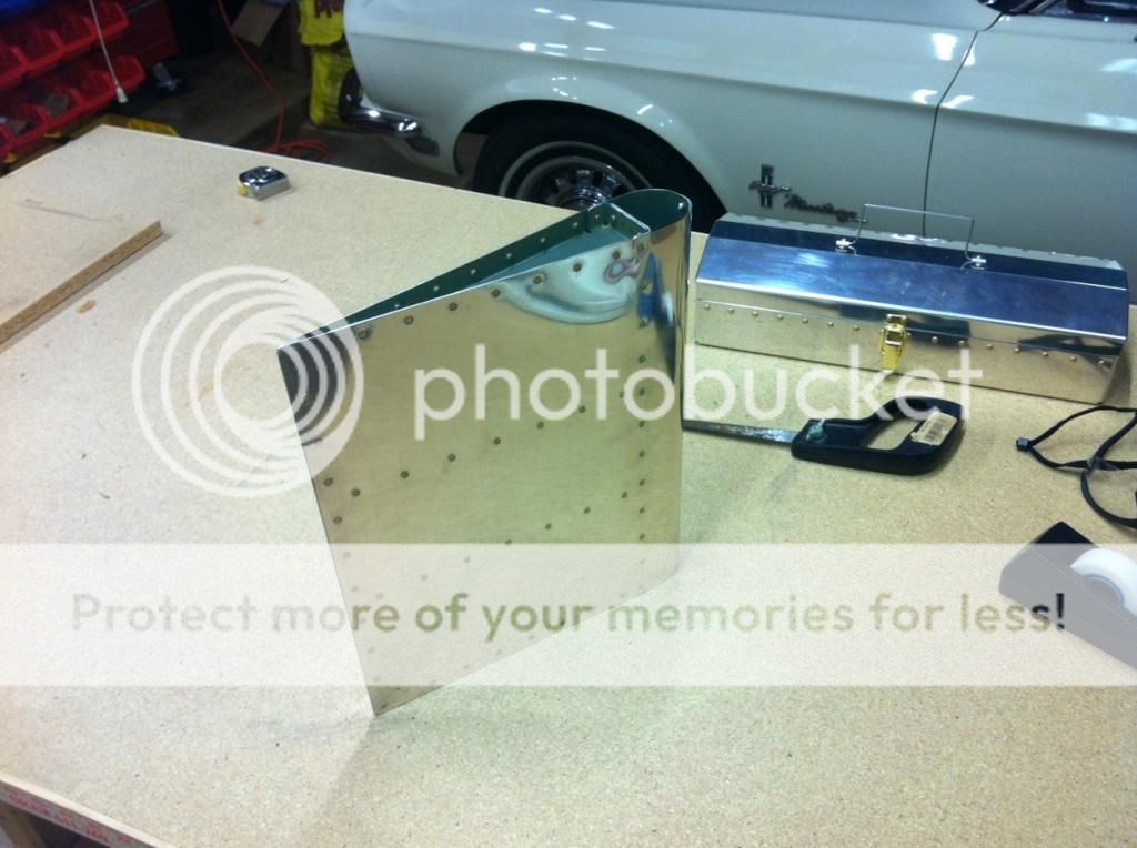

Unscientific Primer Test Results
I completed the practice kit today. Both primers held up well except to the bucking bar. Some scuffs and scratches. Hard to see in photo. All in all, I was surprised by how well the duplicolor held up and a little disappointed in the Eastwood epoxy. I expected a bulletproof epoxy, but it was not. Not sure how it compares to the Akzo. Supposedly the Eastwood does not need a topcoat since it is an epoxy primer. I am probably going to use the Eastwood. Just don't want to get into the time involved with the spray gun and Akzo. Only question is how much to prime.
I primed before doing any work on the kit to expose the two primers to as much abuse as possible. For the airplane, I will prime after dimpling. Pretty good results dimpling after the prime, but not 100%. Prep will be cleaning with Eastwood Pre-Paint (degreaser/cleaner) then scotchbrite pad followed by Dawn soap and warm water

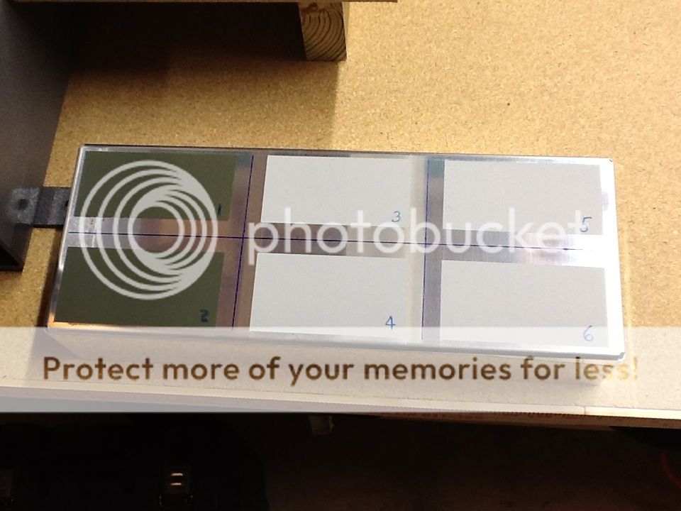

Tool Box Primer Test Photo
Previously I posted a photo of primer samples on the tool box. Below is the final photo after my abuse tests.
Notice the round patches of bare metal on the duplicolor samples. I rubbed them with acetone on a paper towel for about 5 seconds. The Eastwood samples were rubbed multiple times but I could not get them down to bare metal. The samples had been dry for about two weeks. The scratched areas in the middle of the samples were done with a nail. The miscellaneous scratches appeared during he build process from setting on aluminum shavings, etc.
After starting the empennage, my current decision on priming is to prime the spars,ribs, etc, but not the skins with the Eastwood. The alclad on the skins looks great after the first clecoing. The ribs, spars, etc got pretty scratched up during the demurring, dimpling, and clecoing. i don't want to scuff the nice alclad and apply a coating that i am not 100% convinced is better than alclad. I feel this is sufficient based on my location, hangar, useful life (of me), and available time.

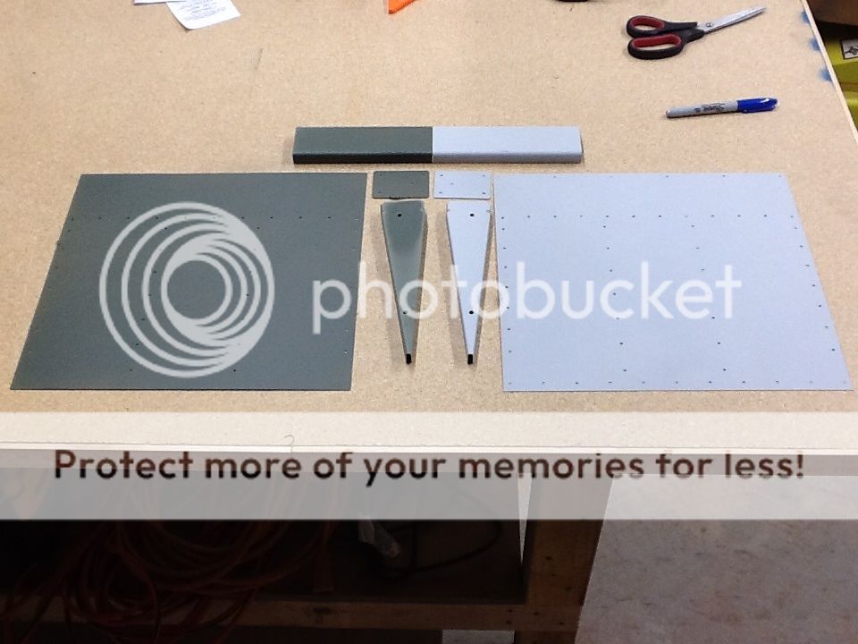

Update on Eastwood 2k Epoxy Primer - Rattlecan
I am well into my fuselage build and thought I would post an update to the thread. I am still using the Eastwood product with very few issues. RV-14 Empennage kit required 11 cans ($220). I found that if you refrigerate the can after activating, you can get about three weeks out of it. After that, it still spays but the product fills rough when applied. If you store it at room temperature after activating, the can seems to clog after a week. I try to use it in batches within 48 hours, but occasionally keep it longer. I have had a test sample primed sheet of aluminum outside for 1.5 years and it is holding up well (but so is just the bare ALCLAD surface).
In my mind, the savings for me are the time spent mixing, prepping gun, and cleaning up with the spray gun method. Not money because it is expensive! But I can grab a can and spray within a few minutes. I guess only time will tell for sure.
