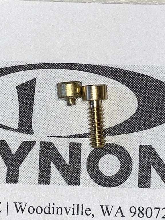

This pic is the old style broken shear screw and the new replacement.
The old one, pre 2017 has a machined diameter below the head of .070, the new one is .100.

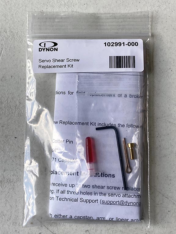

The packaging, shear screw, allen wrench, cotter key, loctite and instructions.
A very complete repair kit.
