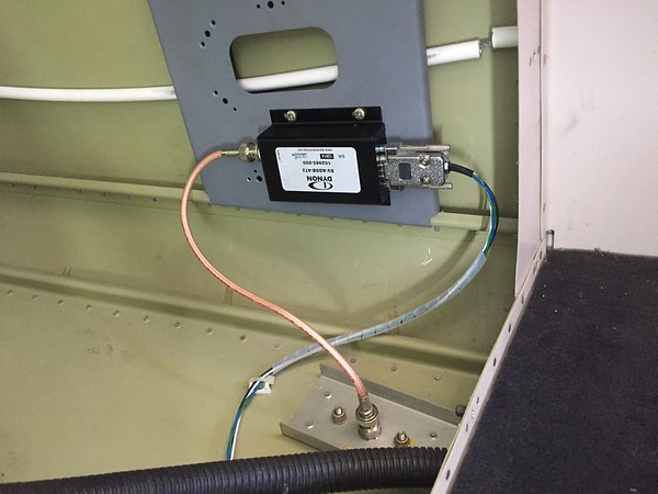

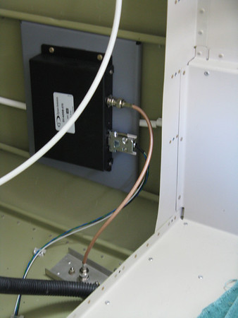

They called me last month and I recently did the swap for the new unit. I had waited about 18 months.
It works great. The hardest part was getting back there to take out the old unit and move the mounting nutplates around on the bracket for the new unit's smaller size.

It's very much worth it. And the tradeup is completely plug-and-play with the current 470 wiring, all you have to do is change the nutplate/screw mounting locations as the 472 is quite a bit smaller and lighter.
