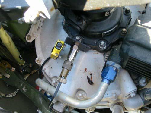

Of course, I'm not Walt -- but here is a vibration sensor bracket I made and it does sound similar to what Walt described. Made of .125 aluminum and quite stiff.
Two metric bolts secure it into unused tapped holes on the gearbox.

Do you just drill a hole in the prop bulkhead when you figure out how much weight to add?
I don't have a pic of my sensor with mount but it does not look like the above, its simply a small 90 deg piece about .75"x.75", it bolts to the case and the sensor bolts to it, similar to the pic below mounted on a Bell gearbox. The one above looks like it would induce it own vibrations.
Good point, I'll modify it.
N112DR -- yes, drill hole and use a/c hardware for weights.

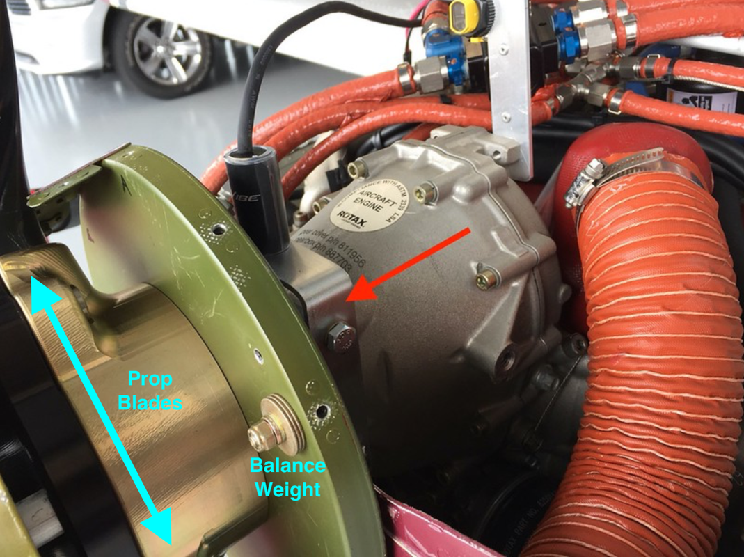

I'm looking at Tony_T's photo of balance weight added to the spinner backing plate. It looks like the weight is almost 90 degrees to the prop blades. I would think that the weight would be located near one of the blades (lighter blade). This would make sense for static balance but maybe not for dynamic balance?
Another thought I have is dynamic balance along the axis of the prop shaft. The balance weight is not in line with the prop arc. This would be analogous to balancing a car tire with lead weight only on one side of the tire. Car tires split the balance weights (in/out) and even use different size weights to adjust for balance point across the width of the tire.
This would be an accurate assumption if the propeller has its mass exactly centered on the chord wise axis (perfect construction), and it is mounted perfectly centered on the prop shaft, and all the other spinning mass in exactly on centerline.
The amount of weight looks to be more than one ounce. Is there a limit on the amount of weight per location?
We’re just having a friendly conversation here so don’t jump down my throat…. It’s been over 40 years since I had a course in Dynamics and I guess it shows. It would seem to me that statically balancing a two-bladed airplane prop would entail adding weight to the lighter blade, or conversely, removing weight from the heavier blade. The dynamic part would be adding/removing weight from the right location on the blade so that both blades have the same “weighting” from the hub to tip. This is sometimes done on full-scale helicopters and is very common on radio-control helicopters. Unfortunately, not doable on a full-scale airplane. See… https://youtu.be/OUPUEvi7hRI
So, getting back to my post #19 above, it still seems to me that the balance weight would be placed on the backing plate (because it’s convenient) but directly behind the lighter weight blade. Maybe I’m just blowing smoke…

I have not yet tried to stiffen the mount shown. It could be stiffened by shortening the L holding the vibration sensor, but that would move the sensor off of the centerline of the prop shaft. Doing that could result in difficulty interpreting the phase angle displayed. The same picture was sent to the instrument manufacturer and they said the set-up looked OK. Also, if the vibration sensor is resonating the results after adding weights won't make sense. My readings all make sense. The weights installed in the picture brought the IPS down from an initial 0.76 IPS (rough) to 0.08 IPS (good). A vibration level of 0.76 can be felt pretty strongly on the rudder pedals and the throttle handle. Adding an additional AN960-10 washer brought it down to 0.03 IPS.
The weights shown are the only weights. You may notice another hole on the backplate, that was the initial balance years ago before the Sensenich front hub was replaced per SB.
