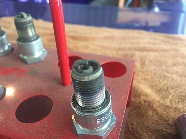

I have dual P-mags installed with each one firing both top plugs on one side and the bottom on the other. The bottom plugs will always have more lead build up than the top ones.
You can see the lead blob built up on a bottom plug here. (and yes, I lean aggressively on the ground and fly Lean-of-Peak)
The plugs get tossed every 100-140 hours. The automotive ones only cost about $24 to get eight new ones.
