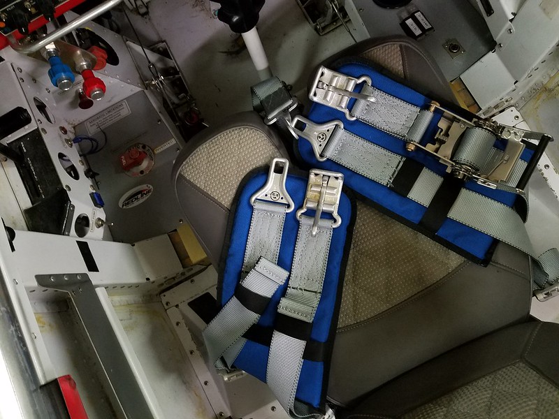

I finally got around to installing the 7-point Hooker harness in my RV. The hard part is devising a second attach point for the lap belt. I suppose some will attach both belts to the stock attach points but that does not give the optimum geometry for the belts and does not provide redundancy for safety. I needed to provide a second set of attach points further forward for the ratcheting belt so that the belt will securely hold my upper thighs from raising off the seat during negative G flight.

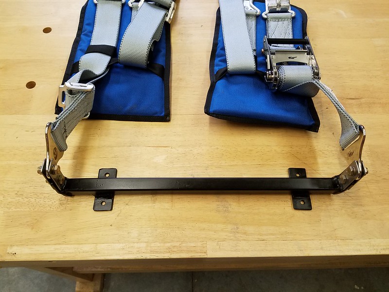

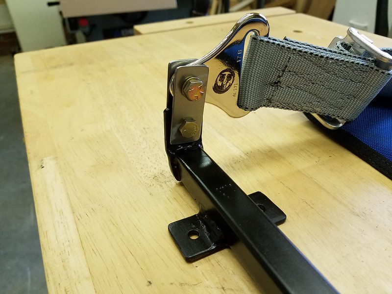

I used a 3/4 inch square steel tube that is welded to two tabs that secure the tube to the two floor longerons with four AN-3 bolts. The bolts go through the longeron angles and into nut plates secured to a 1/16 inch thick steel doubler. I welded some little tabs onto the end of the 3/4 inch square tube to attach the ratcheting lap belt. The seat cushion is quite thick over the tube but I cut a bit of foam out to let the cushion rest on the tube.
Prior to installation:
Belt attachment detail:
![](/community/proxy.php?image=https%3A%2F%2Ffarm5.staticflickr.com%2F4830%2F31390808397_3975eb6ede_c.jpg&hash=bac61dbe73aa32b5605edb2a4a2f45a3)
![](/community/proxy.php?image=https%3A%2F%2Ffarm5.staticflickr.com%2F4804%2F32457732178_878b5c907f_c.jpg&hash=a7b2fc64946bcf690da96598f2c97517)

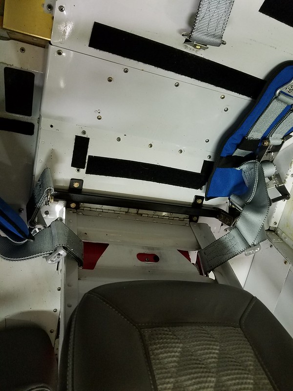

Installed:
![](/community/proxy.php?image=https%3A%2F%2Ffarm5.staticflickr.com%2F4858%2F32457733348_32f8f93cff_c.jpg&hash=758e250c0a3a6f9ca87b9650f87f2d84)
That ought to hold me!
