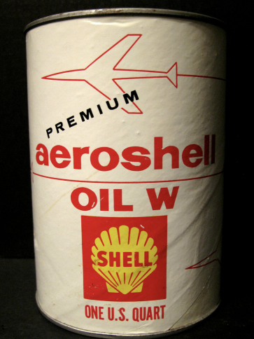

This thread reminded me (my age is showing) I had a case of Aeroshell left over from the 70's. Oil "can" was actually paper back then. I was cleaning out the garage last summer and found the case of old oil like an archeology dig. Every "can" was leaking at the spiral wind and some cans were half empty. I gave the case of oil to a guy and he used it in his Cub...
