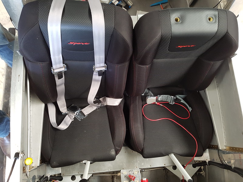

If you want to DIY your seats, take a tape measure to your local automotive wrecker and see if you can find a pair small enough. I installed a pair from a Suzuki Swift in my -9 last week and they fit like a glove, don't weigh all that much, and are quite comfortable. My writeup on it.
