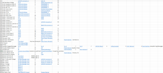

Once the circuit diagrams were done, I could enumerate each and every circuit in the airplane, give them each a code/name, determine wire gauge based on the current requirements and how long the run will be. Also whether they need to be shielded or not. As a rule of thumb, I shielded everything that carried an analog or digital signal, including and especially audio. I printed each circuit name on heat shrink tube to uniquely label each wire. Don't forget the grounds. I chose to have an independent wire to each tab on the tab forrest, and ended up with a little over 400 circuits. Don't skip this, because you're going to at some point need to answer "which wire out of hundreds is the RS-232 RX wire for my transponder?"
7. Connectors
From here, you know how many pins each connector needs to hold, and what kind of connector it must be, so you can buy them. I went with mostly Deutsch connectors and some circular plastic connectors. I also named/labled each connector to label them physically in the airplane. My list is here. For each connector, I planned which connector pin got which circuit, so they all lined up when I plugged everything in. Don't forget, for shielded wires, you generally want to have a shield drain on each side of the connector, and pin the shield circuit through the connector. Think about which connectors you want free-hanging, and which ones you want as "bulkhead" connectors physically attached to the airframe. I didn't leave many spares (this is probably a mistake) so if I needed to run 6 wires through my wing root and wanted it disconnect-able, I used a 6 place connector.
