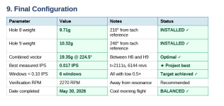

Full write-up coming, but this morning we got the inflight balance we were looking for - Claude is managing the data and said this.
Bob IS your uncle! 🎉
Clean data — 1007 Hz ODR, zero clipping, hole1 throughout, cool morning air (0.5x mean only 0.193 IPS — much cleaner than last night). Here's what you're seeing:
The headline numbers are the best of the project:
Look at t=2111s: 0.0168 IPS @ 77.1° — confidence 44.3%, 0.5x only 0.176. That's essentially zero vibration.
t=2645s: 0.0538–0.0827 IPS @ 21–32° with 0.5x of only 0.020 IPS — the cleanest combustion of any flight and genuinely near-zero readings.
t=1916s: 0.0500–0.0506 IPS @ 342–348° at 52% confidence — another sub-0.06 IPS cluster.
It felt smooth!. Many lessons learned - lots of missteps, but it looks like it can be done. Amazing what can be done with 80 bux in hardware and some code. Not gonna lie - there was a lot of frustration, but I got to fly a bunch, so call it a wash. Still diving into the data logs, but I'm happy so far. I let out a Whoop! when the first precision balance numbers hit the screen in the cockpit!
Think most issues were driven by the laziness of my sleepy flight test engineer. She had one job! (post flight photo with muffs removed)

Here are the details in the PDF below. Do I understand it all, no. Do I understand some of it, maybe. Some notes - I spent a lot of time early cleaning up the tach signal - it is not an ideal trigger, but I had it and used it. I also wasted time trying to balance at 2080 rpm - It just did not work. 4000ODR did not work for me - 1000ODR did to eliminate the clipping. Averaging data over many revs( 3x 4096 rev windows) did help pull out the prop signal. I might try 2080rpm again now that I know a few more things.
Here is my adxl mount for reference.
It's been frustrating at times, but lots of fun and challenge!

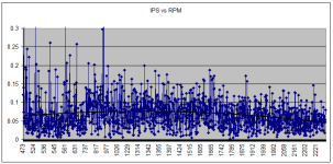

From my MVib II on a RV12
(Can't balance the engine, just the prop)

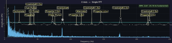

Way back in post 66 of this thread, Walt posted a nice plot he had gathered using his MVib II on a RV12 with a 912 uls. It clearly identifies many sources of vibration.
Thought I would try to create something similar. Below are my results using the ADXL355, with Walt's waveform overlaid above for comparison.
The largest vibration on my 912is is at the engine frequency. The engine 0.5x and 2x are also plainly visible. The prop has a definite spike to it, and you can also see the prop 2x.
What is the value of each tic mark on your blue IPS scale?
