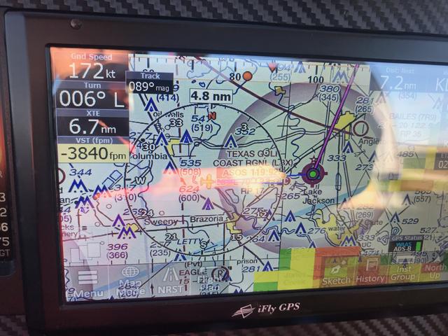

The nexrad radio picture is all but useless. The picture is displayed just as received with no reprocessing. It is very blocky and makes no sense. I have talked to walter and he says better wx radar pictures are coming, but who knows when.
Interesting. I've seen NEXRAD in Avare, it looks pretty reasonable. I've also seen it (via SiriusXM) on the 496; it looked like a very early 8-bit video game gone wrong. Good enough, really, given that I'm VFR-only and generally try to stay as far away from all but light precip anyway. If you've seen what I'm talking about, is it about like that?
This is wx radar from this morning displayed on the 740 via stratux wifi.
Yeah. About what I saw on the Garmin when it had XM WX.
Pretty impressive dive, by the way. :)

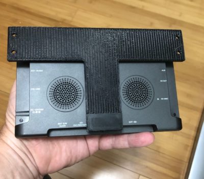

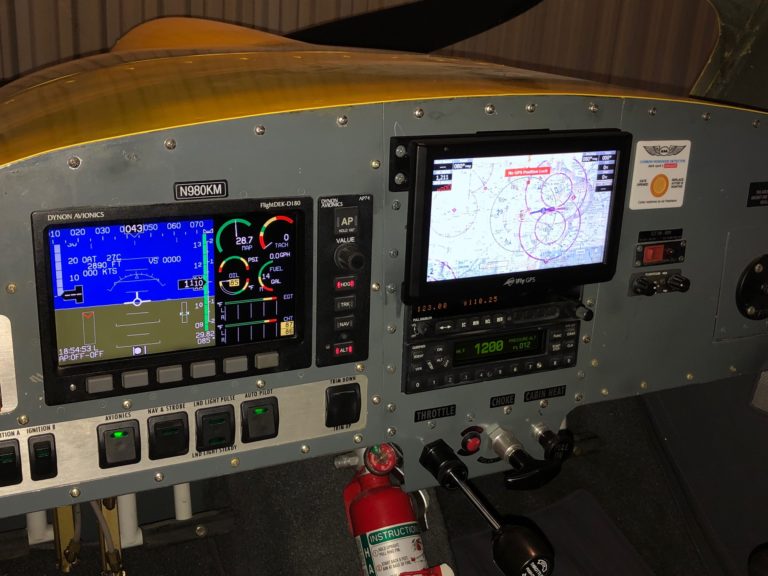

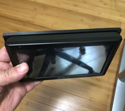

iFly 740b GPS device is on its way. I have a wiring harness figured out for it to plug in as a direct replacement for the Garmin 496. I haven't worked out the exact details of the mount yet -- I'll need the physical device here first. Adventure Pilot's web site is kind of thin on details about some things. I'm going to poke around and see if I can find the docs from the source device manufacturer -- I suspect these are generic little touch screen boxes. Anyway, I'll post details and pics when I have a chance to get it installed.
I received the GPS early this week. It's pretty nice. If I were designing it, I'd have put the connectors in different places. The power and USB are on one side, and audio is on the opposite side. Having them all on the same side would be much more convenient in almost all cases, but it's not a big deal.
My goal is to come up with a way of mounting the GPS on the panel without it looking like a crude hack. The GPS uses a non-standard method of mounting. At first I saw this as a problem, but in reality is just presents an opportunity. The AirGizmos dock is far too wide to fit in the center stack of the RV-12, at least horizontally mounted. I'm pretty sure it would be too tall to orient it vertically. I decided to invest a little time learning to use the EAA-sponsored free student version of SolidWorks to design a mount to do what I want.
A little time with a micrometer getting measurements of the vendor-supplied suction cup mount showed a pretty simple arrangement. I spent a couple of hours re-learning to use SW, and printed up a test plate with the mounting arrangement to see if I had the fit right before going further. I just printed it in PLA, since it's not going in the plane. Much to my delight, it was a perfect fit. More to come as I get a better idea of how I want this mount to work.

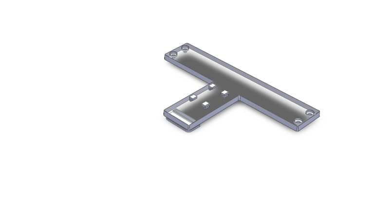

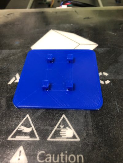

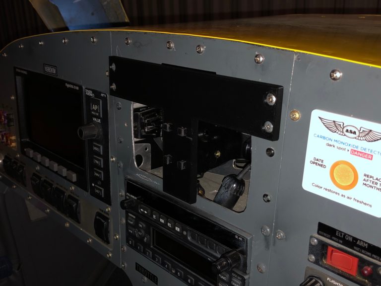

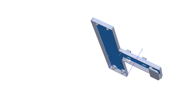

I had what I thought was a pretty good take on a mounting plate for the iFly 740b. I printed off a "template" -- I just reduced the thickness to .050 and printed that, so I could take it tot he hangar and check the fit.My thought was to capture the top of the bracket under a couple of existing panel screws, and just have to drill one hole in the panel for the bottom.
After doing some test fitting and taking a few measurements, I think I have a better approach. Tomorrow I'll be printing one with all the changes. The bottom end will have a clip of sorts to attach to the bottom of the existing opening for the Garmin 496, without the need to drill any new holes. The top will attach using two of the existing panel screws on either side. There should be enough room for the cables to slip in behind the iFly and pass through the opening for the 496. Looks like a 7-plus hour print job.
I also need to wire up the new harness. I've got all the cables and connectors here, just need to start stripping and soldering. A single harness will plug into the existing GPS DB9 socket on the AV control board provide power to the GPS, NMEA serial data to the D180 (and radio, should iFly support frequency switching), and stereo audio -- without the need for an isolation box -- to the intercom.
More pics to come, as soon as I have something good to show.
5-1/2 hours of printing goes from this:
to this:
I'll try to get to the hangar and test fit it tonight. Before I finish I'll dunk it in acetone for 30 seconds and let it cure for a day, just for a little added strength (there was a Sport Aviation article regarding that).
Dale ?
Cool project - you?re installing iFly 740b in place of the Garmin GPS at top of radio stack in older RV-12.

Last night I took the mount and GPS to the hangar for a test fit. I'm happy with it, with a minor reservation. I may need to move the mounting lugs up a quarter inch or so if the bottom of the GPS blocks the view of the radio. I didn't try it from the seat, so I won't know for sure until later on. Mechanically, though, the mount installs perfectly -- slip the bottom groove over the bottom edge of the 409 opening, remove two screws, and use them to secure the top of the mount. There's plenty of room to feed the cables through behind the panel. I brought the mount home and dunked it in acetone for a few seconds, we'll probably paint to match the (exceptionally ugly) panel before doing the final installation. I'll fly with it a couple times before deciding whether to make any further tweaks.
