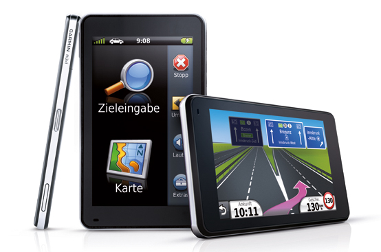

New Garmin 2400 Series
Garmin just announced it is coming out with a new nuvi 2400 series navigator which has a 5" display. I called Garmin to see if they are going to make this into an aviation version and they had no reply but hinted to wait tell Sun & Fun. I'll wait a little before ordering my 560 just in-case this happens.

I am hoping that Garmin releases something better that the Area 500/560, now that the 495/6 is at the end. Wonder what happened to the 595/6 range.
So I am hoping something with a higher resolution 800x 480 and thinner, like the new Nuvi 3700series form factor, with multi touch.
https://buy.garmin.com/shop/shop.do?pID=63940
One can only wish!
