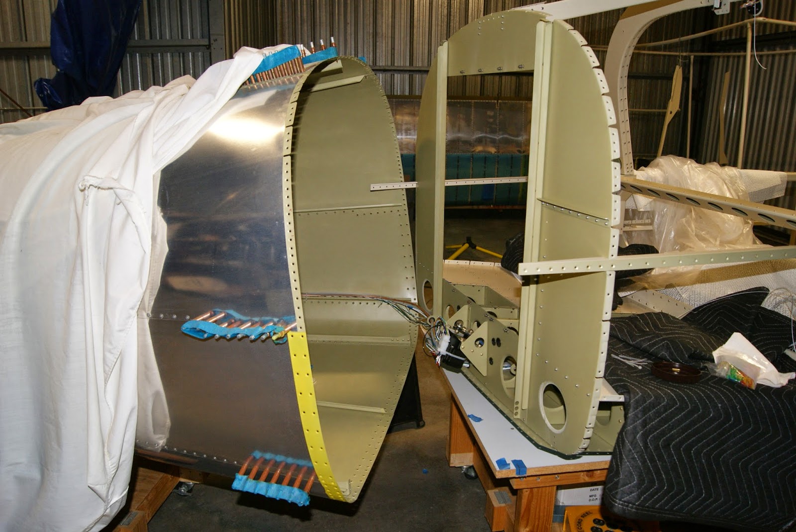

I would hold off on installing the fuel tank until after the tail cone is mated. It will make it MUCH easier for you to install the fuel tank venting hardware. Below is a photo of the wiring installed in the tail cone and the space I left myself to install the ADHRS.
I actually installed the wiring and ADHRS in the tail cone prior to mating by canting the tail cone sideways (was in a hangar so had the room). The fuselage and tail cone were on benches (same height) with wheels. I also left the side skins off for a very long time and when they did go on, I left the forward portion unriveted so I could reach in from the sides to install the rudder pedals with no fuss at all.

I'm installed the adsb ant. in tail cone along with the vans support bracket while tail off. It's easier to install the flaperon act. to wings with the tail off. Have fun
