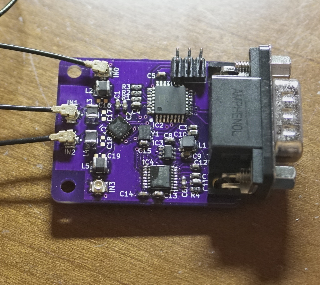

I'm working on some more refined capacitive fuel sensors that can compensate for (and likely distinguish between) different fuels and still maintain accuracy. Does anyone know if this has been done before in experimental aircraft? I suspect this is how Boeing/Airbus sense fuel levels.

You don't need to worry about density. Boeing needs it because turbine engines traditionally manage fuel quantity in terms of mass (lbm or kg), whereas we use volume (litres or USgal), which can be measured directly just using capacitance.
Also, 28-bit resolution may be much more than needed, depending on the capacitance range of your transducer. The Van's capacitance plate setup (one at each end of tank) gives a range of very roughly 150pF (empty) to 300pF (full of avgas). For my RV-8's 21 USgal tank, this gives about 7 pF/USgal. The precise numbers will vary a bit depending on details of tank construction, but they won't be too far from these. If you then use a 10-1000pF transducer, for example, 12-bit A-D conversion would resolve about 0.25pF, or better than a tenth of a USgal.
I've developed a similar system, using an Arduino with 10-bit A-D conversion, and get good results with it during initial bench tests.
The 4 input circuit pictured - where can you get that?
This is a custom board I designed around a TI FDC2214 frequency-to-digital converter. I may sell a few if there's enough interest after I do a bit more testing/tweaking. The next rev will probably ditch the U.FL connectors and put BNC directly on the board.
I agree 28 bits is excessive, but it's pin-compatible with a slightly cheaper 12-bit chip. I wanted to be sure I would have plenty of resolution if my capacitive plates ended up on the small side.
Analog output would be easy to add with an opamp.
Energy per volume would vary slightly with temperature. If we can measure volume with 28-bit precision then why not be excessive and try to output a constant value independent of temperature. :rolleyes:

If (added) CPU chip also has a D/A output you won't need the op-amp to produce the requested 0-5V analog output. You may even be able to produce an analog output that would (accurately) feed Van's fuel gauges over their full range.
If you expand the options to enable calibration in 1 gal increments I think you'll have a huge market for it!
As for retrofitting tanks w/o capacitive plates, consider a tube within an tube to be snaked through existing rib holes. (The outer tube will need holes in it at regular intervals to let fuel in/out.)

rev2 board testing
Today I tested rev2 of the board which fixes a few issues and made some firmware updates to output actual capacitance and % full. With my test sensor, I'm able to resolve down to 0.1% increments with a capacitance change of 343pF.
My bench meter reads the sensor as 110pF, and I'm measuring vegetable oil which has a dielectric constant similar to gasoline around 3 (gasoline is ~2).
343/110 = 3.12 dielectric constant, so I believe I'm calculating this correctly.
@Canadian_JOY Interesting those are the first I've seen that have a second sensor. The instructions mention that it auto-calibrates when full is reached, which is a clever way to solve the problem. I guess the only downside is it doesn't measure the entire tank.
@FinnFlyer The measurement chip uses 3.3V power and I used the same for the MCU so that makes getting 5V out slightly more complicated. An opamp on the 12V input with a small gain would be more flexible and handle the extra current that may be needed to drive resistive-style meters.
