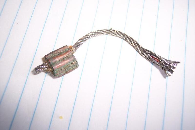

Here is the 3/32" copper sleeve that failed on me.:

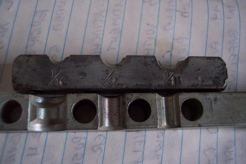

Here is the $54 A-T-S tool (which I have since tossed in the trash) that I originally used to make that bad crimp. I freely admit that I may have not used the tool properly somehow but you can see that it only indents the sleeve on one side by design:

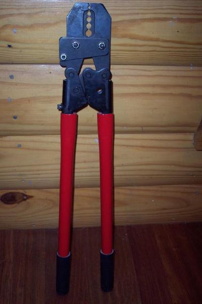

Here is the proper tool for crimping Nicopress sleeves ($325 Locoloc hand swager) which a friend loaned me (go/nogo gauge not shown):

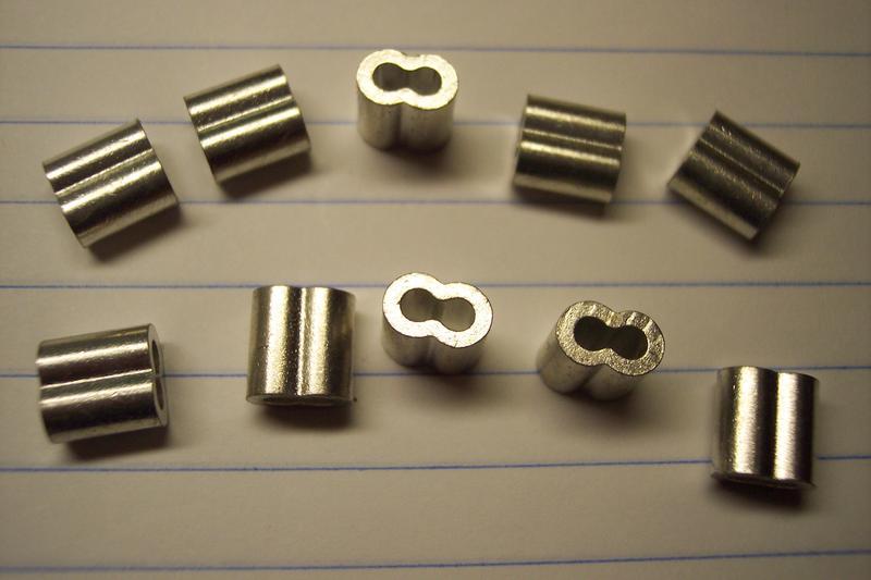

Here are the 3/32" tin plated Nicopress sleeves which are recommended for use on stainless cables:

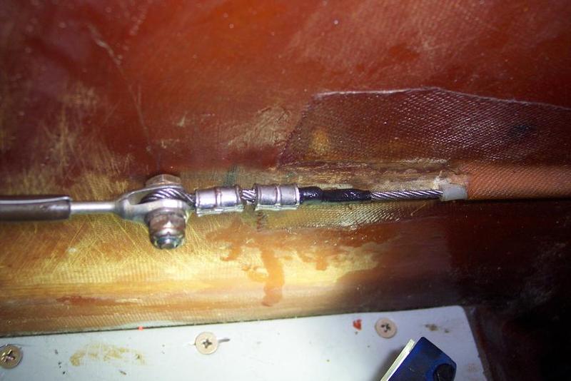

...and here is what good crimps are supposed to look like:
Notice that I used two crimps in series, which some folks say reduces the strength of the assembly. I accepted the possibility of a minor reduction in the 920 lb. breaking strength in favor of the redundancy. I'm funny that way. Flame away...
![cFMFn7.jpg](/community/proxy.php?image=http%3A%2F%2Fimagizer.imageshack.us%2Fv2%2F800x600q90%2F923%2FcFMFn7.jpg&hash=ac3f77ff26772163db0819612a98b28c)
