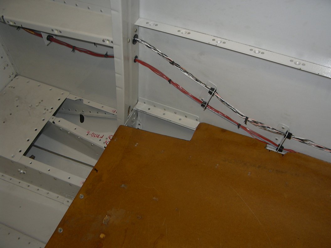

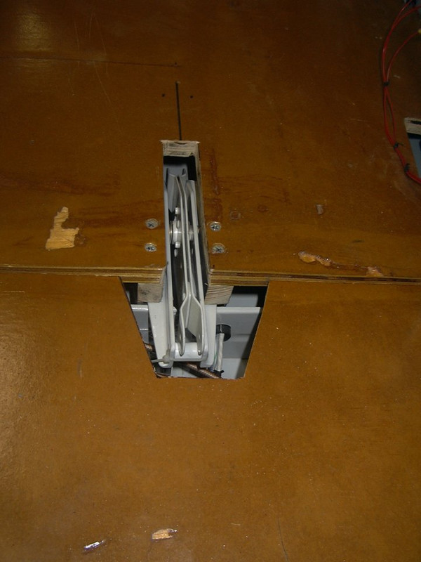

I don't play one [RV-12 builder] on TV and I didn't stay at a Holiday Inn, last night. That said, for the other RV models, Vans recommends that you fabricate some temporary wooden floor boards so that you can rivet the top turtle deck skin on and do other work back there without damaging anything.
Naturally, I overdo everything. I figured why do a shoddy job on this, as I will need to get back there for the annual condition inspection every year. I glued two layers of the thin finish plywood that Vans uses for shipping boxes, then cut the temporary floors to size. I sanded the edges round [makes them easier to install and remove] and coated them with 2 coats of varnish [A friend had given me what was left of a gallon can]
I made cardboard templates first to test the fit. Best to make these BEFORE you rivet the turtle deck skins on. Round all the edges so that you can get them in and out with the turtle deck on. See photo below. These are for an 8A.
Multiple pieces will be easier to install and remove. If you plan to save them for future use, be sure to make cut outs for the elevator bell-crank and any other obstructions which will exist in the finished tail-cone.
