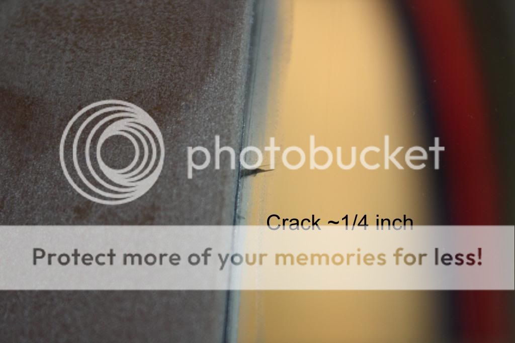

I have a small crack in the windshield and I wanted to ask the opinions of the builders if I should proceed or replace the windshield. I am pretty sure the crack is a result of using Locktite on the screws the night before fiberglassing the windshield fairing. The windshield was covered with tape plastic etc. so I didnt realize the crack was there until I removed the tape. My thoughts are, #1 I could build on, test fly and see what happens before I paint it. #2 maybe drill stop it and add some sort of glue. (What type of glue) #3 Remove and replace.
Any advice would be appreciated.
(A word of warning. Dont use Loctite anywhere around the canopy)
