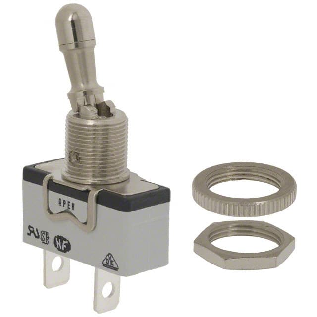

As a LOP WOT flyer that sometimes use mogas,having the feature to easily adjust my timing by just one switch,sealed the deal for me.
