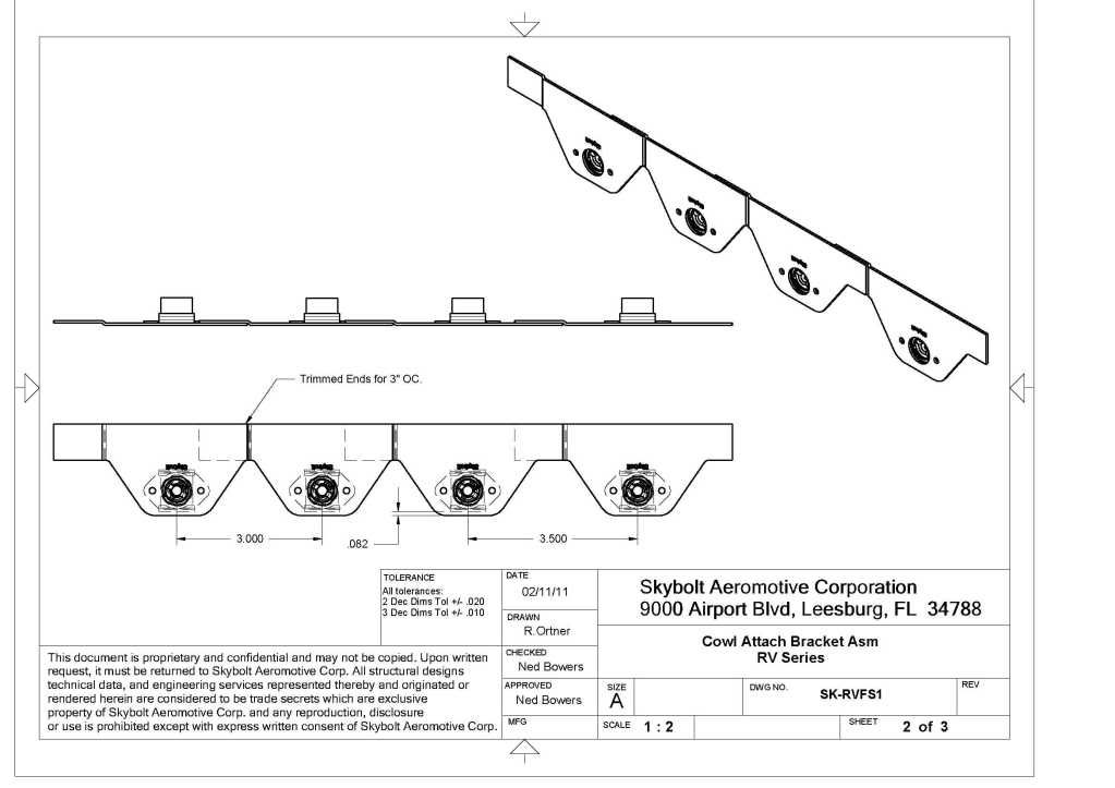

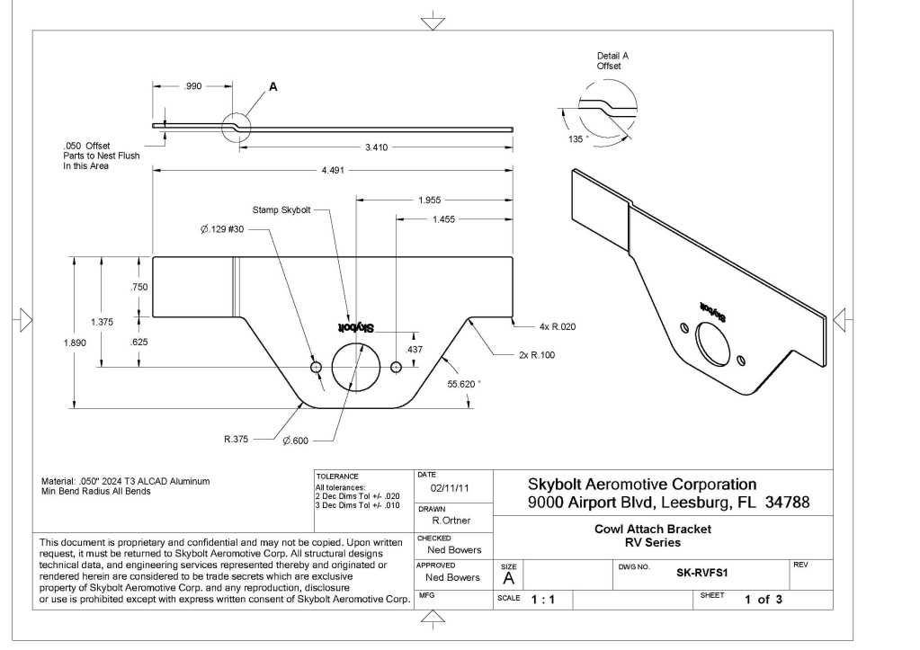

After years of design work on aircraft cowlings, I finally came full circle back to the typical Vans Cowling and the builder option for Camloc or Skybolt CLoc 1/4-Turn Fasteners. The challenge has always been the supporting flanges to mount locking receptacles. Looking at alternatives, with input from many builders, our team came up with the interlocking flange concept. When we finally got it to look good on paper, we built a mockup of an RV8 cowling to not only test the concept, but to see if it "looked" good enough to place our name on it. In the process, we were able to evaluate the cowling construction from beginning to end, using Vans instructions, our experience, and a new approach to building and trimming a completed cowling. I encourage all builders to view the Skybolt Vans Instructions posted on our website so that you may evaluate some great options for your current or future project:

Segmented flange sections....what a clever idea!
Ned, the only suggestion I'd have has been discussed here before. These three gaps have a bad habit of capturing the rear corner of a cowl section when you reinstall after maintenance. It's a scratch and chip thing. My next airplane will get solid flanges (no scallops) in that short section along the side.

Dan: Thanks for weighing in. Going back to another recommendation you made to me referencing floating receptacles versus non-floating receptacles, I did make a radical change to tradition when I built this mockup by approaching the project with 100% non-floating (adjustable) receptacles. This eliminates all concerns of dynamic cowling ?shift?. Using the sequence of trimming as referenced in my instructions, prior to trimming the sides, I found that a few ?floating? receptacles allowed me to move the trim line ever so slightly to close any remaining gap at the firewall. Then I trimmed the sides and installed all non-floating receptacles along the sides. Thus, based on your recommendation, I used only 6 floating receptacles in a complete kit in the upper firewall, three on each side; relying on the non-flaoting receptacle as the prominent part. This cowling fit close to perfect (a relative term in the world of craftsmanship) at all trim lines with no cowling ?shift? at all. Your input did indeed drive me to think along these lines that broke tradition. I thank you for your suggestion.

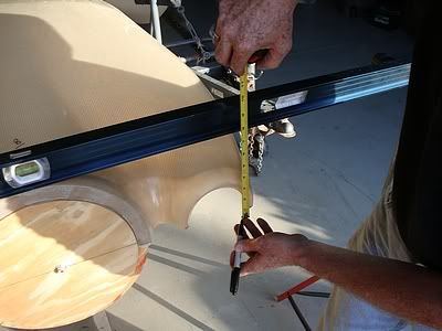

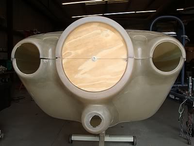

Using Skybolt's new interlocking flange system, this RV8 colwing mockup was completed in a weekend prior to our forums at Sun N Fun.
To accomodate engine mounts, sharp curves, other obstacles, the interlocking flange system allows the builder to easily position flanges/fasteners. Once flange positioning is determined, outer skin (cowling) fastener holes are easily located at center due to transparency of cowling skin. The pre-fabricated flanges save considerable build time and allow a very professional finish even if this is your first project.
