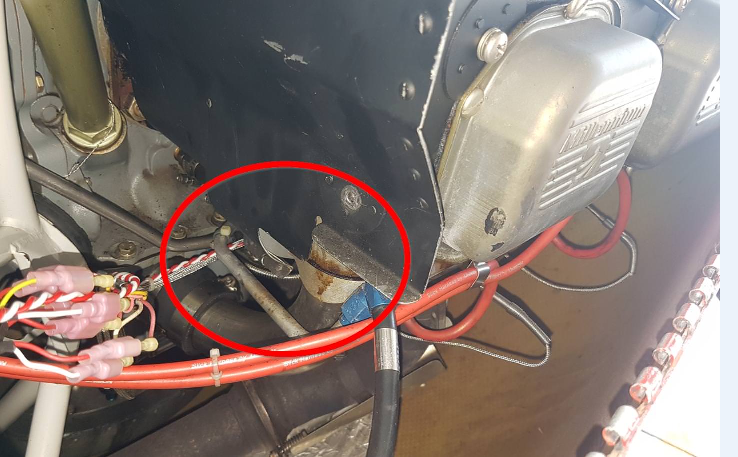

That said, many of the people who "think" their baffles are good are in error. There is a lot more to it than just aiming some air in the general direction and hoping for the best. Every molecule of air that comes out the exit needs to have gone through a cooling fin first or its a waste.

The RV-4 used to cool fine with the O-320 in it, but when we went to an O-360 with 9:1 compression cylinders, it runs real hot on climbout without use of cowl flaps.
Sure would be nice to know what I was doing wrong with the baffling so I could fix it. Baffling fits good all the way around, Liberal use of RTV everywhere I could. My no 2 cylinder has small fins in front so no need to do a bypass around it.
...My no 2 cylinder has small fins in front so no need to do a bypass around it...
Can you define "small fins"? There is some variation between manufacturers, but the deepest I've seen so far (on the 360/540) is only about 1/8 inch - not nearly enough. And how about the rear of your #3 - same?
Two cowl flaps installed. Adds significant operating (temp) flexibility. Does cost money, weight, noise, and drag when open. Am I'm just about trained to connect the power to the actuators when reinstalling the cowling now after a year.
One issue with the EZ Cool devices. The fasteners need Loctite, and I felt like the actuator needs insulation. I strapped a small piece of foil backed cloth on each one of mine.
Front fin on no 2 is about 1/8 in deep. Used washer in back of no 3 cylinder. All four cylinders run about same temp.
