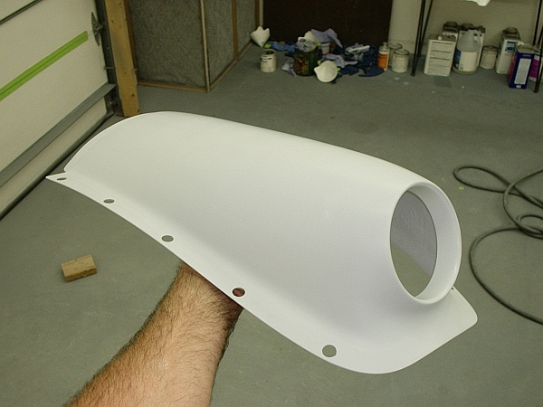

Appreciate the effort to post links. I am not a performance or speed addict, but lots of food for thought.
The Vans FAB was a real bump in the SJ cowl bottom so I sent it back and fab'd a custom with oval filter (K&N 60 SI surface) to narrow the GUPPY fish look. Still not happy with looks. AFP says their FM-200 cone is more than adequate and that agrees with K&N tech criteria. So, the dilemma persists, use a cone up high or big box (ugly cowl) down low.:confused:

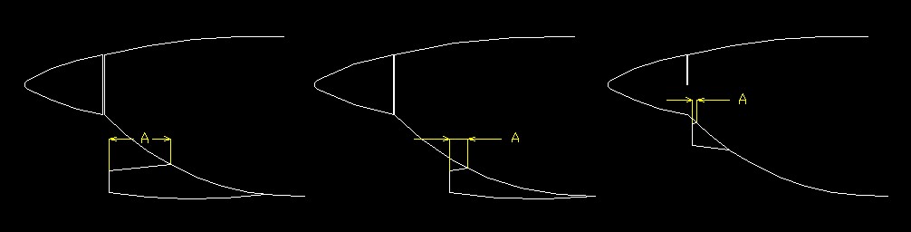

This requires a picture!
First example projects out to a point very near the blade path, and is at a significant radius from the hub. Example 2 is located at the same blade radius, but doesn't project forward as much. Example 3 is near the blade path, but at much less radius and higher, near the spinner.
Steve, your thoughts please. I'll venture that #1 and #2 would result in pretty much the same intake pressure, climb or cruise, thus my previous note saying it doesn't need to be way out there. However, as you say, if dimension "A" becomes too short, flow following the cowl face will reduce available dynamic pressure. So, returning to Larry's question, is there a rule of thumb for a minimum dimension "A" ?
Also, the "corner" flow below the spinner where the flow has to turn through an angle to match the front of the lower cowl has pretty high pressure to start with. That is why the P-51 inlet is there. And the intake on the F-1 Rocket.
Agree, Example #3...decent pressure in cruise, although I don't think it will do as well in climb. In cruise, that location exhibits relatively high pressure, but with low forward airspeed, it's too inboard to harvest any significant dynamic pressure found in propeller outflow.
When working with cooling inlets at maximized prop radius, low speed, high power climb coefficients of pressure are much higher than the available freestream dynamic.
I get it, this is a looks thing. You are not too concerned about efficiency.

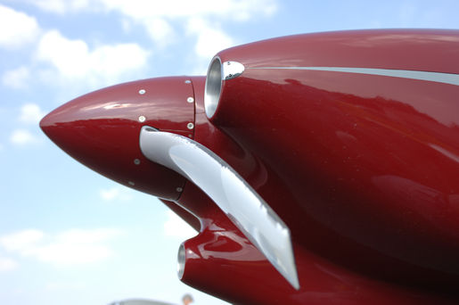

This is what you want:
https://www.jamesaircraft.com/products/air-filter-kits/
You want the FI no bottom hump look? Sam James will allow you to have no or little bottom hump with carb... SJ has a right angle snorkel that transitions to forward facing, duct to the inline air-box. However with the O-360 that is a BIG carb and the engine is taller than than an O-320... Good luck, shows Pics when done. Love to see the solution.
There is nothing really magical about round unless you are going to have a venturi shape (curved surface) in the throat of your round intake... and then an efficient plenum right behind that. Round, "D", rectangle... Up to you and your taste. Just have generous radius on the lip of induction inlet and sufficient area... with nice smooth transitions preferably to larger area plenum to convert ram air (velocity) to pressure before going through filter. This is what the Van FAB box does well. Placement of your induction scoop relative to prop was mentioned before.

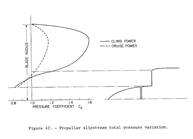

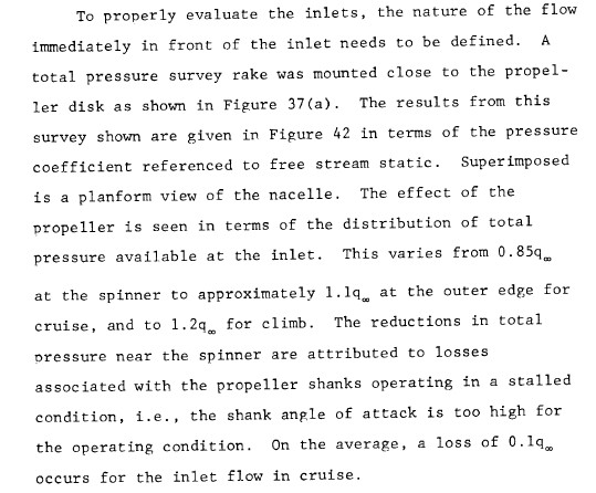

This from CR3405. Seems to suggest a definite benefit to locating an inlet at the largest practical prop radius.
Observations based on measured upper plenum pressure during a 100 KIAS climb at WOT:
http://www.vansairforce.com/community/showpost.php?p=1177277&postcount=198
Again it is important to have a nice leading edge lip on the inlet, both inside and out. The inside lip will help prevent separation as the flow turns into the duct from any angle misalignment, and the outside lip will help prevent separation that would be spillage drag.

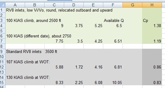

One of our RV-8 builders has been gathering cowl pressure data, so i asked him to do a WOT climb and record. The result is interesting in the context of this discussion.

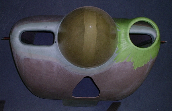

His cowl is stock RV-8. Mine has round, low Vi/Vo inlets relocated outboard and slightly upward. This photo from preliminary work circa 2008, showing both inlet types:
This is pressure data, mine circa 2012 or so, and the stock cowl yesterday. Note difference in Cp:
I do not wish to treat one data sample as an absolute truth. However, it matches the CR3405 indications, and I would be delighted if other builders would make the same measurements to expand the sample base.
This is interesting, because the distribution of stagnation pressure fairly closely matches the distribution of bound circulation on the blade. This probably makes sense, since it is the bound circulation that is doing all the work.

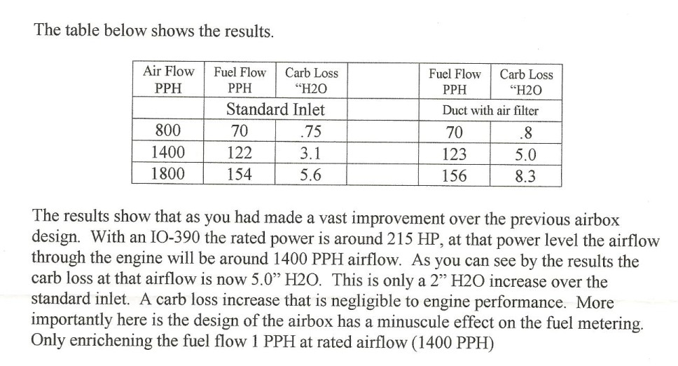

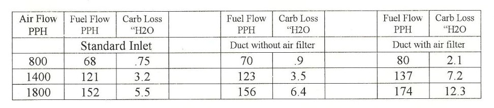

The common term is "carb loss", the pressure drop due to intake restriction. It applies to any flow restriction, not just carbs.
Is it a worthwhile service? Yes indeed. One measurement can banish a lot of BS.

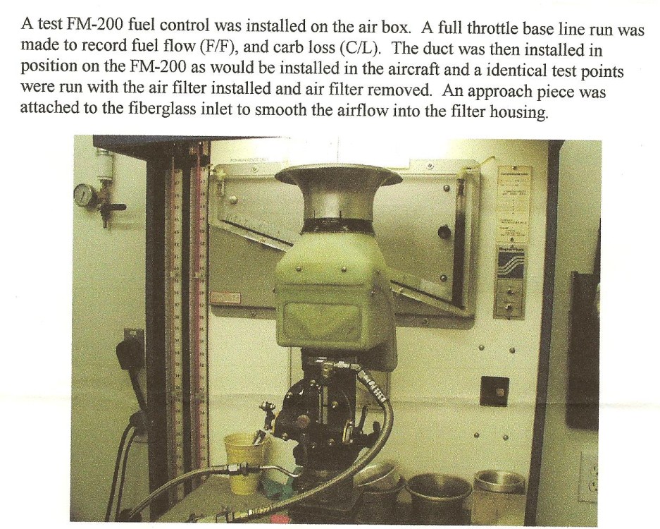

Here is some of that banishment.

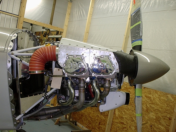

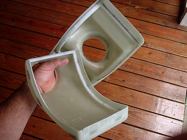

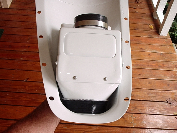

Early construction photo, a diffuser-type airbox with a K&N RU-3120:
On the flow bench at AFP, it was not great; in addition to merely being restrictive, it also drove the FM-200 slightly rich.
And test results for a new airbox with a large area, deep pleat K&N 33-2124...a loss of 2" H20 (0.147 Hg) in return for full time filtration.
That big bell mouth on the intake will produce essentially ambient stagnation pressure in that air box.
Is that intake diameter what will be on the airplane? Or is that just the airbox intake, and there would be a smaller intake tube in front of that with a diffusing transition?
If there is a smaller intake tube in front of that and they had modeled it, with a small bell mouth on the inlet, they would have captured any potential loss due to separation of the diffuser.

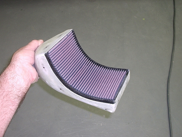

Dan, could you make a sketch of what the internals of that airbox looks like?
It looks like that is the test article pictured prior? It looks like the test has the same inlet diameter that the airplane has, with just a small diffusion in the front third of the box?
And although you cut the loss in half compared to the original diffusing inlet with the conical filter, that one only added 4" H2O loss, which still seems pretty small.
Bell mouths when testing articles on a flow bench are standard ware. You can end up with some nasty turbulence otherwise which can nix the accuracy and validity of the tests.
Good to see actual numbers here Dan. You have a very efficient filter system.

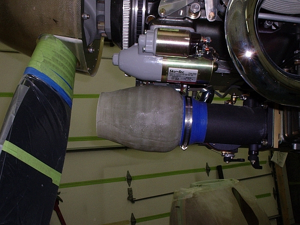

4" ring leading directly into the airbox. The idea was to go low Vi/Vo, like the cooling inlets, reducing risk of separation.
Best photo showing both halves of the box. The filter is trapped between the rails. Yes, the same as pictured earlier. 4" into 4", short internal diffusion, which I really wasn't depending on for much.
It is small, but the goal was to get filter loss down to near nothing, like an open, unfiltered intake. As it turns out, the filter loss here is just a wee bit less than Rod Bower posted for the open butterfly on his intake.
The test surprise (illustrating why a trip to the flow bench has value) was how the "bad" intake was driving the FM-200 rich by 11% or so. A/F would have been about 10.2
Yes of course. Drawing from still air, a bell mouth needed in either case.
Really nice. Yes, as with cooling intakes, external diffusion is always best. (low Vi/Vo)

Sucking through the big reed valves, the loss was 29.29 less 27.88, or 1.41" Hg, or 19" H2O.
We should note that these measurements appear to have been made on Lycon's test stand, which is a prop dyno...it supplies the intake with ram pressure from the prop outflow, not static pressure like most dyno installations.
I see about 0.25 in. hg. loss on mine going through the conical filter compared to straight ram. My air supply for the filter box comes from the #2 intake cooling ramp through a 2.5" scat tube with no inlet lip at the ramp. But with the butterfly open and full ram, I would not expect any noticeable loss.
Now I'm surprised, as you're describing something I didn't know existed, a Bower system with the filter canister fed from a ram air source. Are there no reed valves in your installation?

Most dyno installations indraft from nominally quiescent air in the enclosure, which, with a good bell mouth, should be the same as stagnation pressure. Albiet not boosted stagnation from a propeller.
Yes, I made my canister myself with a ram air source. No reed valves. It just didn't seem to make sense to indraft the warmer, lower pressure air in the lower cowl plenum. I've also been concerned that those reed valves may not seal all that well.
Hmm. I was never at all clear on how the mixture adjustment works on a Bendix RSA-5, but leaning it did seem to reduce my WOT fuel flow - perhaps my imagination.
Ahhhh.
Agree, sucking hot, low pressure air through reed valves makes no sense.
Got pictures?
See this old post:
http://www.vansairforce.com/community/showthread.php?t=49556&highlight=ram+air
In that post I mis-stated the pressure drop through the filter. In previous and later posts I stated it correctly. Filtered = 0.25" hg loss at cruise power (2400/24) and 0.3" hg loss at take-off power.

I have upper plenum pressure plots for three RV8's. Assuming stock exit size and decent baffles, upper plenum pressure will ballpark around 0.95 Hg at 170 KTAS and 3500 ft. You've seen the piccolo tube setup. They don't measure right there in the inlet, so we can't be super sure you have the 0.95 at that specific location...but its a fair assumption.
What is the area of the ram intake under the spinner?
I remember now, thanks.
No shutoff for the ducted supply when the butterfly is open, which means both intakes are providing pressure. That's clever. It's possible the cooling intake has more available dynamic pressure than the ram inlet.
Interesting thoughts. I always figured the cooling intake probably ran slightly lower pressure than the induction inlet, and that I was probably leaking a little bit of my induction pressure with back flow through the filter and into the upper cowl plenum. But I don't know. It doesn't seem to be much flow either way.
It is hard to assign a hard number for the induction inlet area, because the lip is such a generous radius, and then it starts to transition to round right away. It is customary in the jet engine inlet world to use the "hightlight" area, which is to the leading edge point of the lip. If I count it that way, I'm guessing something like 12 sq. in. If instead, I take the area to the inside tangent point where the lip ends and the duct starts, subjectively, it is probably about 9 sq. in. The cylindrical tube with the butterfly valve that runs into the filter can is 3" dia, so 7 sq. in.
I have the picollo's installed, I just haven't gone out to fly the test yet. I have to go down to the sacramento valley to get down to 3000 msl and I've been waiting for cooler weather, which is now. I'll try to do it this week.
Assume 12 sq inches, 170 KTAS, 3500 ft, std day, and 2400 RPM. Available ram would be 0.85" Hg, a little less than what appears to be available at the cooling intake. However, throw in filter and duct loss, and it would probably be a wash with the butterfly open
if we use the 9 sq in value, available ram drops to 0.67" H, and the cooling air route would probably have positive flow.
