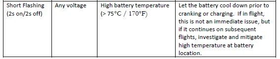

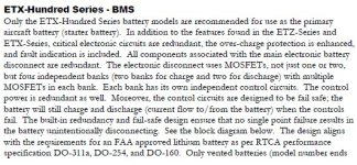

I ran into this today. EarthX has added more technical details. Battery temp will be fine as long as you mount them higher FWF. I made the mistake of mounting my second battery low. I have washer type thermocouples mounted halfway down the front and the lower battery consistently runs 30 deg hotter than the top battery on climb out. I have asked the engineers at EarthX the effect of routinely doing this and I was assured not a safety issue just hurts long term longevity. I test the residual ampacity annually and recently replaced my top battery once it dropped below 80%. It lasted over 4 years.
Note the comments recommending the use of hundred series batteries for starter batteries in aircraft.
BTW 85 C is 185 F.
