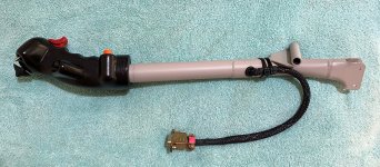

L Larry KMYA Member Patron Today at 11:54 AM #1 How have you secured the Com cable and control stick wires allowing for the motion of the stick? Photos would help. Attachments IMG_8308.jpeg 861.5 KB · Views: 13
rv6n6r Well Known Member Patron Today at 2:13 PM #2 RV-6, not sure how similar to RV-14 but here's a pic. Comes out the bottom of the stick, zip-tied over to the left on bottom side of the control tube with enough slack for full motion. Attachments IMG_20210113_185123277.jpg 655.7 KB · Views: 5
