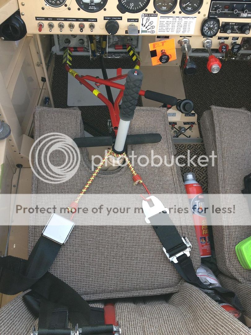

Ran across this on EBay for $49, cannot find anything in the archives, has anyone tried this with success?
[/IMG]
Hey Don,
They make several models of this, including one specifically for the RV-12
I thought about one, but Van's tow bar does a pretty good job of locking everything; brakes, rudders, and stick.
Tom
I installed one on my Rans S-6S. I haven't had the opportunity to use it yet, but I think in will work just fine.
Jim
I have one in the 9A and use it regularly. It works very well and in conjunction with the rudder lock, rock solid.
I have the RV12 Vans tow bar which doubles as a rudder lock, thought this would close all the remaining problem areas.

Bogi-Bar as control lock????
I JUST tried this yesterday, and was shocked how close the tow bar was to a decent lock. I bought a bunch of PVC pipe to see if I could make it clip to the pedals and stick somehow.

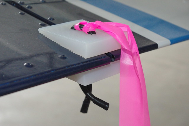

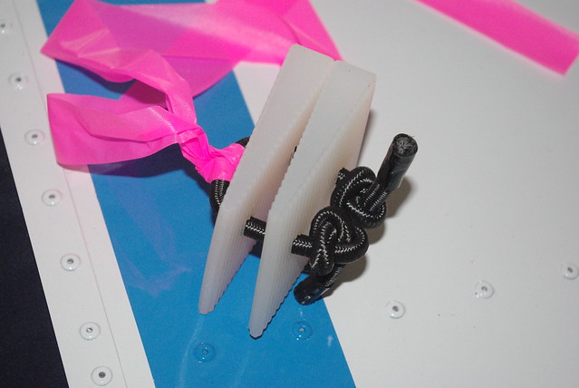

Flaperon lock
Not a complete control lock solution by any means, but a couple of furniture wedges and short length of bungee cord make a cheap and effective flaperon lock. Make one for each wing.
I received my control lock today, as pictured in the original post. I am quite pleased with it, and especially its small size and light weight. I cannot install it until I have the wings back on, so the flaperons are neutral though.
