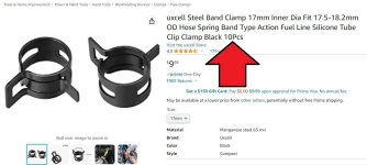

Are these little clamps really $10 each? The Amazon link listed them for right at $10. I thought it was probably for a box of at least ten, but that price appears to be for each one. They must have an FAA certified sticker on them somewhere. 😬
Are these little clamps really $10 each? The Amazon link listed them for right at $10. I thought it was probably for a box of at least ten, but that price appears to be for each one. ...
The description indicates "10Pcs"
