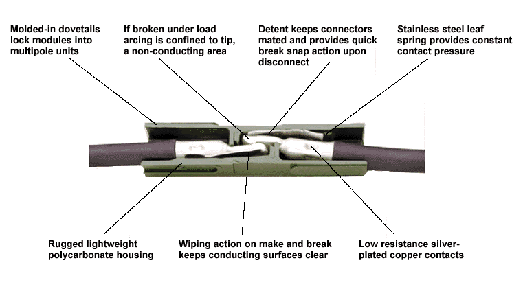

For the few high current spots these Anderson Power Pole connectors work well. A quick look at their contact design will show they are much better suited than Molex pins at high currents.
Pitot heat would be a good location and also the flap motor drive wires.
https://powerwerx.com/anderson-powerpole-connectors-15amp-bonded
For 12-14g wire the contacts are good for 30 amps.
They work in rather a unique way -
