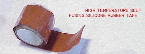

Wiring a 430W, and the back shell with the connector kit doesn't have any strain relief. Or maybe it does, but 3 wires in a back shell sized for a 44 pin connector doesn't quite fill it. Am I missing something here? Looks like I could just fill the little cylinder on the rear of the back shell with to better immobilize the wires. Am I on the right track?
There is usually a bushing that goes around the wires to provide the strain relief on that type of back shell,
similar to this one
You could also use silicone rubber tape to fill the void.
Ok, so kinda what I figured. Connector kit didn't have any bushings or anything, so I'll find something to fill the extra space before tightening the ring down. Thanks!

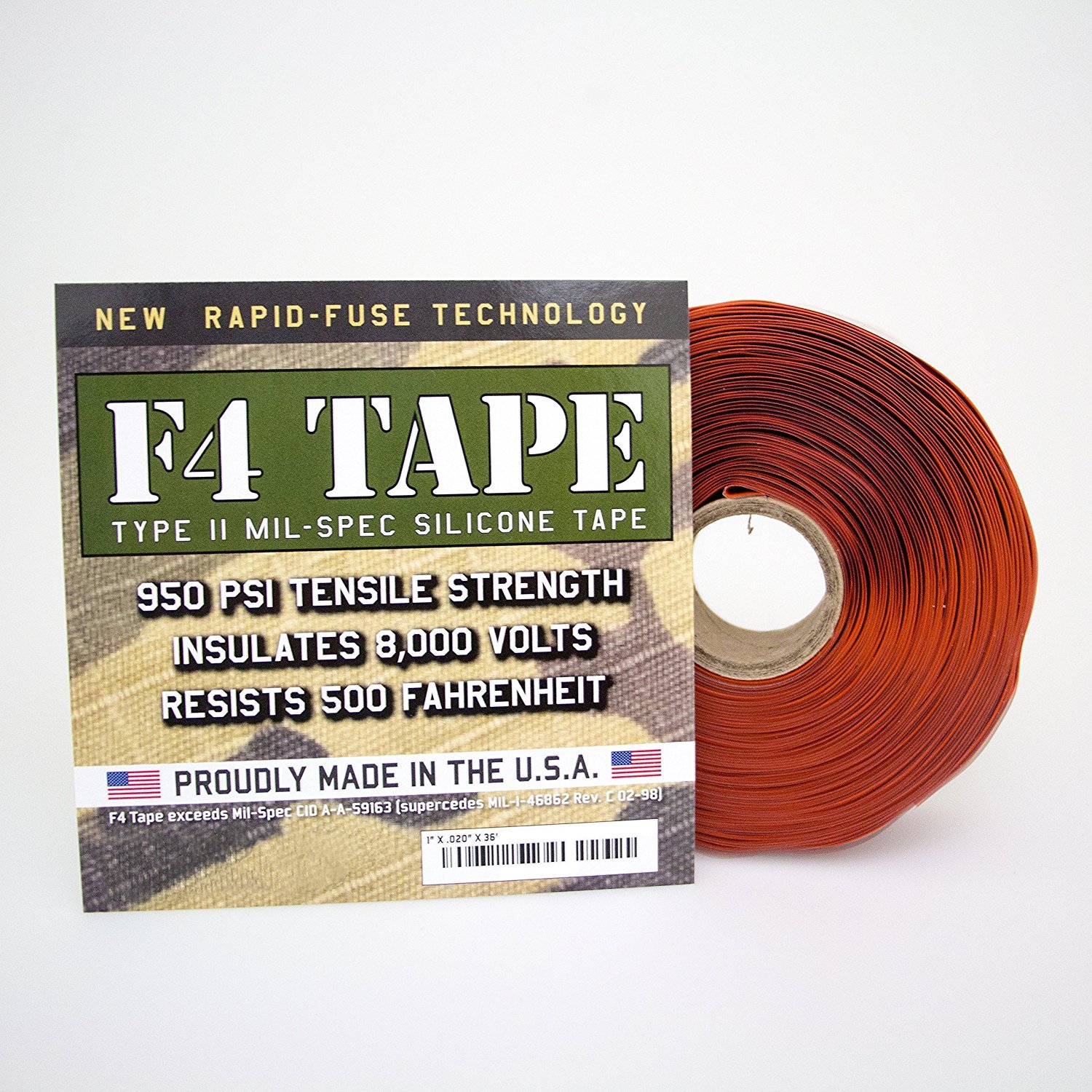

Pick up a roll of F4 tape on Amazon = problem solved.
Do not let the packaging fool you, this is the same stuff the Aerospace Industry uses only the packaging is different and at a lower price.
I worked 30+ years in the aerospace industry before I retired and this is the package I buy for my own use because it is the same stuff at a lower price with different packaging.
Looks like the same stuff I've been using from SteinAir. Slightly cheaper on Amazon per foot, but I've gotten much better customer service from Stein than Bezos.
Same here. If I have an order coming from Stein, I get it there. When I run out and only need one, Amazon Prime is easy plus fast.
