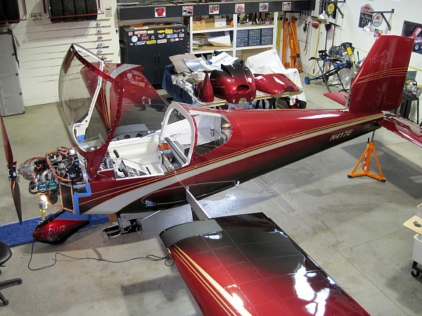

I'm about 2/3rds of the way thru the condition inspection and I discovered a little trick that, at least I, didn't know about before. You know how difficult it is to get the bowl off of the Andair gascolator on the -12? Well, pulling it off has always been difficult for me........until my brain checked in. I realized that I was pulling against a vacuum in the fuel system. Once I pressed and held in the drain valve, the bowl slide right off into my hand. DUH!! Thought I'd pass this along in case you hadn't heard of this either.
Haven't found much of anything so far, just a loose stop nut. I'll be moving on to the 200 hr Rotax maintenance items next.
