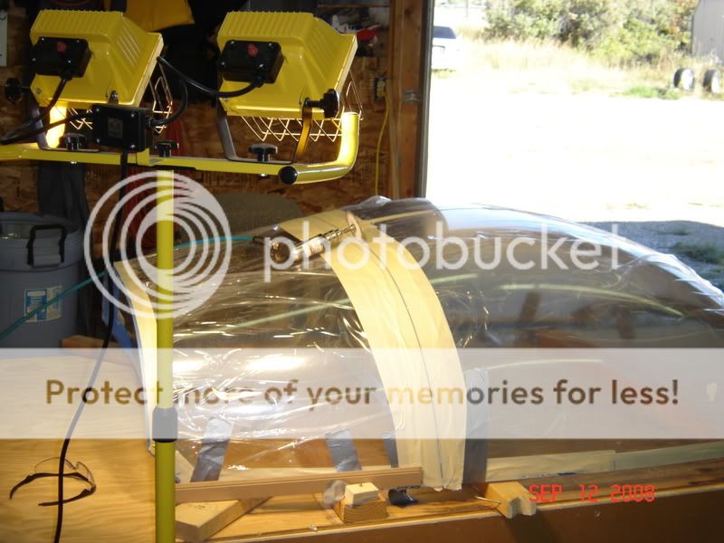

Reading other RV forums, it look like everyone is recommending 75-80 deg temps for cutting & drilling the canopy. Has anyone done any canopy work (sucessfully) at 60-65 deg-- the best I can do in the hangar right now. Looking ahead, I see lots of drilling but not much actual cutting. Am I missing something? It looks like it will be 3-4 months before I can get those kinds of temps. If the consensus is to wait for warmer weather, I'm thinking about hanging the engine, then doing the cowl/spinner work, and then the canopy/avionics.

Halogen shop lights will heat that baby up in no time. Put a digital thermometer near it and make sure things don't get too warm too fast. I took mine from 60* to 95*F in < 1hr.

from my experience the drilling is much more sensitive to colder temperature... as long as the pieces being cut with a grinding wheel are well supported the cutting itself is pretty low risk regardless of temperature. the initial cuts along the side to remove tooling marks are easy to support during the cut with duct tape, trimming slivers away during fitting is a non issue... the only cut that has any real potential for disaster is the 'big cut' from the large mass of each half... so long as each half is sufficiently supported so that they stay put during the cut there is little to fear.
drilling is another matter... test your drilling methods on scrap... try to introduce cracks and get a feel for what will cause cracks in drilling.
although i used a variety of methods i had the best results using a very dulled bit (on a scotch wheel) to bore/burn through the plexiglass for an initial pilot hole enlarged as needed with a step bit and counter sunk with a clean bit in a cage.
for the canopy work you can easily defer making holes... regardless of the temperature there is real risk in drilling that can be mitigated significantly from methods, technique, and experience.

if it is time in the build to do the canopy i would move forward. generally warmer is better but we are cutting with a grinding wheel that will rapidly heat the localized cutting area enough to melt the plexiglass and the real risk is not in the cutting itself but in introducing stress concentrations where they can propagate as a crack... this is most serious as the cut halves near independence and their mass is significantly leveraged at the shrinking connection between the pieces as the cutting is completed. if the pieces cannot move there is little risk of introducing a crack. after cutting, the edges should be dressed and polished a bit before handling to remove stress concentration points.
for the 'big cut' you can easily heat the canopy with a halogen light inside the bubble after you have it sufficiently secured for cutting.
the grinding wheels use a lot of air, unless you have a very large tank the cutting goes pretty slow with a lot of wait time for air pressure recovery...
i am not sure that there is a magic temperature but i would do whatever i could to get an overall air temp above 60, add a spot source under the bubble for the big cut, and concentrate on supporting the pieces during cutting.
