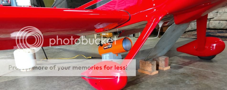

Quick Engine Preheater
I wanted to fly the other day when it was cold and clear. After researching posts here, I put this together out of stuff at the hangar. The blocks of wood support the axles during tire maintenance, the orange heater gets used during annuals and the galvanized sheet metal is a clean drip pan for under the engine. It worked great. Would never leave it un-attended, though and the heater control was left at the lowest setting. Checked belly for warmth and stayed cool enough to hold my hand on it. Air coming out the inlet nostrils was cold at first, then warmed up nicely after preflight and opening the doors and talking to my neighbor. Engine started and sounded nice. RV climbed like a scalded ape in the cold dense air with only me aboard.
PS: That white com antenna in the photo is actually off to one side and not being heated.
You are going to equip your bird with O2....when you have finished attaching your ram jet mod to the under carriage for flights above flight level 60???
Smoking around aircraft is not a good idea, much less operating a blowing flame such as this. There is just too much flammable material around. You would be better off to locate the heater some distance away and conduct the heated air to the aircraft with some appropriate duct hose.

Propane and kerosene heaters aimed at the plane? Not for me.
That's a wonderful setup. Gonna' have to try that.
I do believe you would have a real problem putting in an insurance claim for a burnt up plane using this method.
Probably wouldn't happen in 100 uses....but would be a total loss not only to plane...also hangar (and other planes in shared hangar).

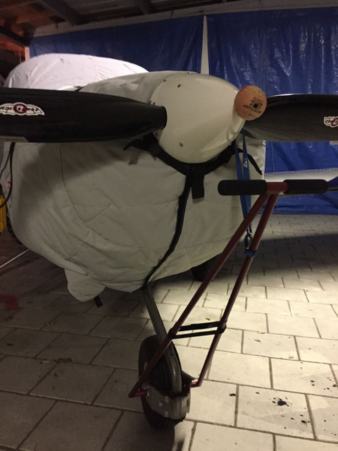

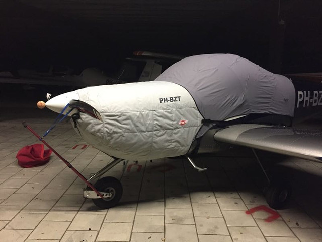

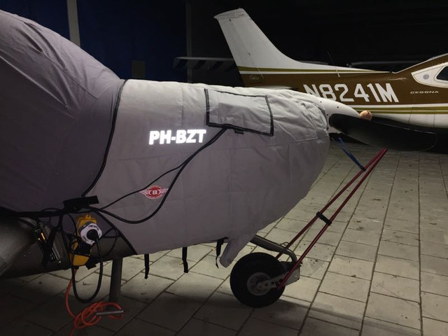

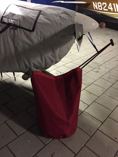

I bought myself a Christmas present; an insulated engine cover from Aircraftcovers.com.
The red bag is the storage bag.
I'm really impressed by the quality and fit (even a protrusion for the exhaust). The Reiff preheater is switched by a WiFi switch (DRH-704 ~ €35,-). Will take some temperature measurements next week.
The reflective N-number is just the icing on a very nice cake.
For just $20,- extra ;-) The cover is not cheap but it's really a beautiful cover
Can you tell us about your WiFi switch?
I initially was looking for a switch with a GSM sim. Thoose switches are more expensive and you need an extra sim card. The company selling thoose switches came with this solution. You only need Wifi in the hangar, no ports forwarding or oher network stuff etc. The switch is controlled with an IOS/Android app. This switch is 240V btw. Works awesome
I?ll butt in here?. I have a cell phone relay switch because I can?t get a WiFi signal at the hanger. If you?re one of the lucky ones who has a strong WiFi signal then I suspect this https://www.ebay.com/itm/Sonoff-Swi...289984&hash=item2ac836da93:g:GL8AAOSwj~VcmErZ would work just fine. Rated at 2200 watts so it will operate an engine preheater.
