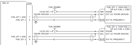

Gulf,
Was your wiring done like this (especially the grounding)?
I think this should work.
Steve
Decided to update GDU460 - had original version - didn't seem to help. Added ground from black wire connected to J244 #7 to power source ground - didn't help. Turned system off & on several times as well as unplugging J244. Then without any clear reason a frequency 0f ~90HZ appeared from both CiES senders on the GDU configuration mode (Fuel 1L & Fuel 2R Digital calibration pages). Right sender worked with or without added ground from power source. Left has only been wired with blue frequency wire to J244 #9, and black and red wired to power source from the start. The only other change made was to replace 1 amp fuses with 5 shown in Steve's drawing? Turned system on-off several times and senders continued to display frequency from each sender.

We will include interface information for these sensors in the forthcoming update to our installation manual. Due to the electrical characteristics of these sensors, power and ground should not be sourced from the GEA 24 or GSU 73. The sensor output (either Blue or Green wire on Fuel sensor) is the only wire that should be connected to the G3X Touch system.
