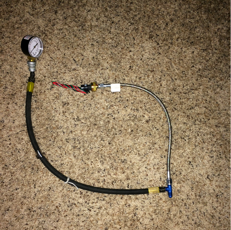

Testing the fuel pressure gauges
I followed advice from Van's, Lockwood, and Dynon. All were helpful. The following are not in the order of progress.
The fuel pump was replaced. The results were somewhat better for a few flights. The Dynon fuel pressure gauge was replaced and compared to a mechanical gauge. Both gauges were remarkable in agreement.

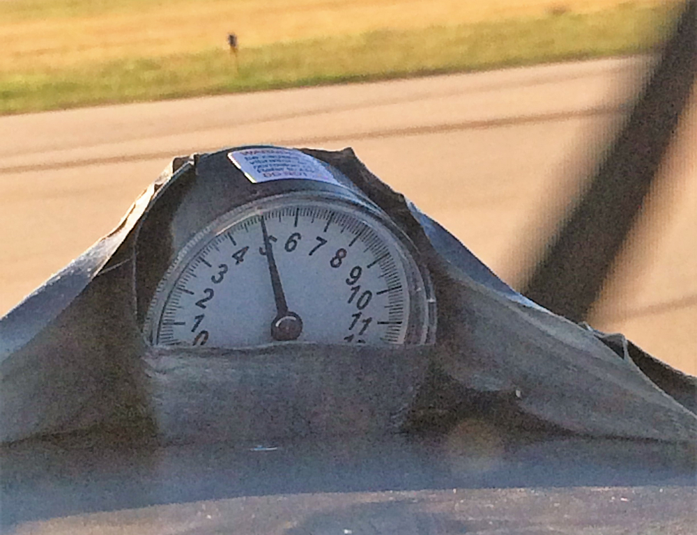

I inserted the mechanical gauge and new Dynon gauge into the fuel pressure gauge line as shown.
Then the mechanical gauge was routed through the hinge pin access port. The duct tape fairing was added and flight checked.

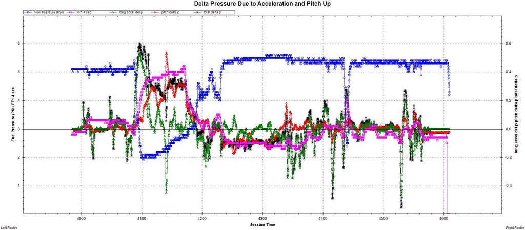

Some graphs show the pressure loss due to acceleration and pitch up

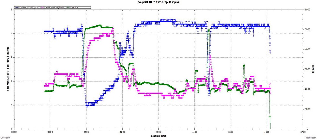

The following graphs were used to better define the fuel pressure drop at takeoff. Skyview captured the USER LOG DATA at 4 samples/second. A freeware program, DATPLOT, was used to create the graphs. The .csv files were converted to .xlsx, trimmed, manipulated, and equations added; and were converted back to .csv. DATPLOT requires that a value be in each cell of data to be graphed. That is, put a zero in each empty cell in the column of data to be plotted.
Fuel pressure has a 4-second lag, that has been corrected in four of these graphs.
The data titles may be hard to read.
Blue - fuel pressure; psi
Magenta ? fuel flow; gph
Green ? rpm; right scale
This flight had a pressure drop to 2 psi during the takeoff (4100). A second drop (4440) was introduced during a power up and acceleration while in flight.

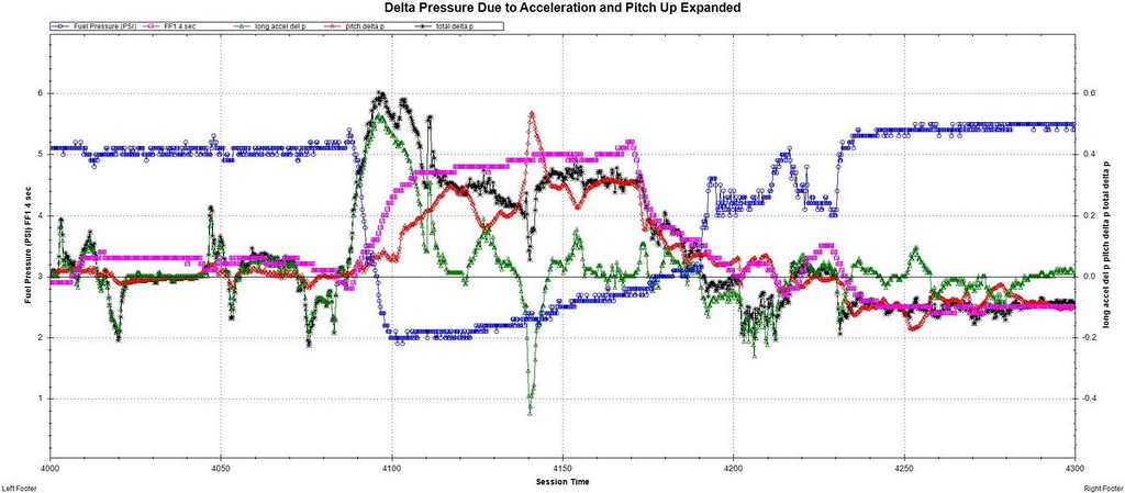

The next two graphs:
Blue ? fuel pressure; psi
Green ? column pressure due to longitudinal acceleration; psi - right scale
Red ? column pressure due to pitch component; psi - right scale
Black ? sum of the two column pressures; psi - right scale
The column pressure due to longitudinal acceleration and pitch up is presented below. The longitudinal acceleration was calculated using the change in ground speed. The column pressure due to pitch up simply uses the increase in height of the fuel pump. It appears that both fuel flow demand and acceleration/pitch up are necessary for the large fuel pressure drop (see 4409 and 4660). For example, at 4409, the fuel pressure drop occurs when the fuel flow and acceleration/pitch up (black line) are present. At 4460, only the acceleration is present with no fuel flow demand or loss of fuel pressure.

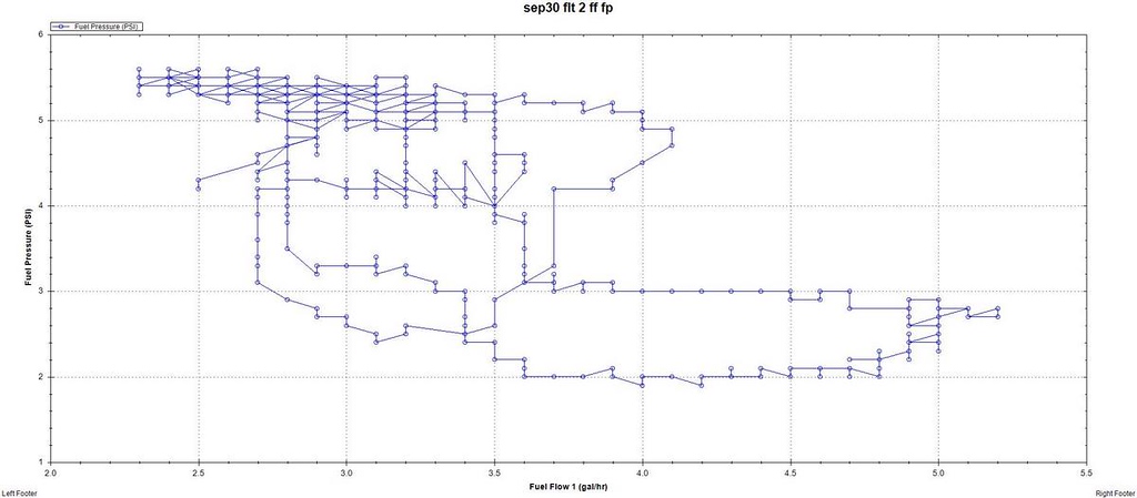

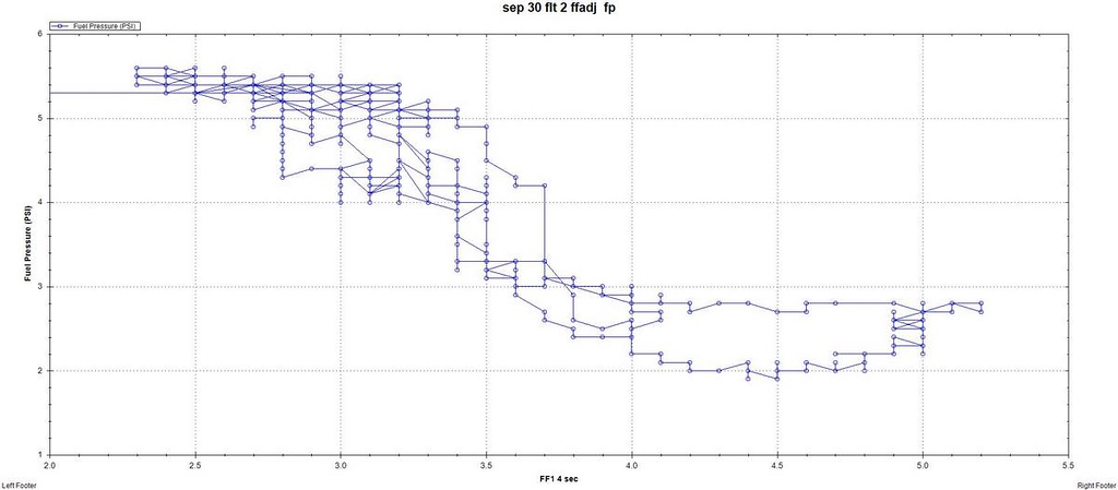

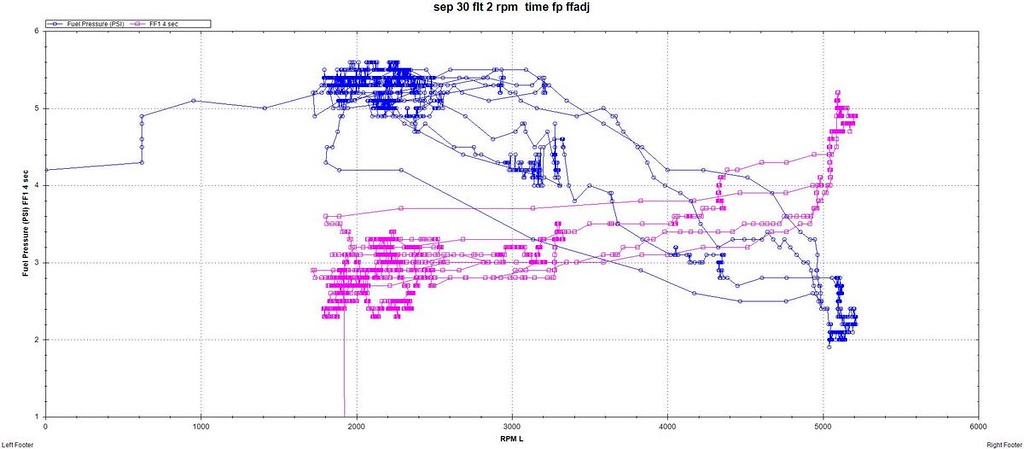

Just an interesting graph. The fuel pressure can be traced from the 2000 rpm group along the higher lines to the lower fuel pressure group at 5000 rpm, then back along the lower lines as the rpm decreases.
The first graph used fuel flow without the 4-second adjustment. The second graph has the 4-seconds correction applied to the fuel flow data. It seems to make more sense. the point is to be careful with the data, I am sure that we don?t know all of the anomalies in the system.
