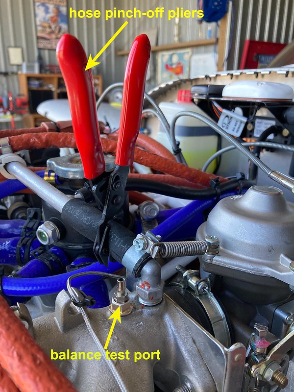

I initially made fittings that went into the rubber hoses on the balance tube. I found that a nuisance to connect up so I went to this method. This method has one drawback in you have to completely clamp off the balance tube or you will show a balance when it isn't.

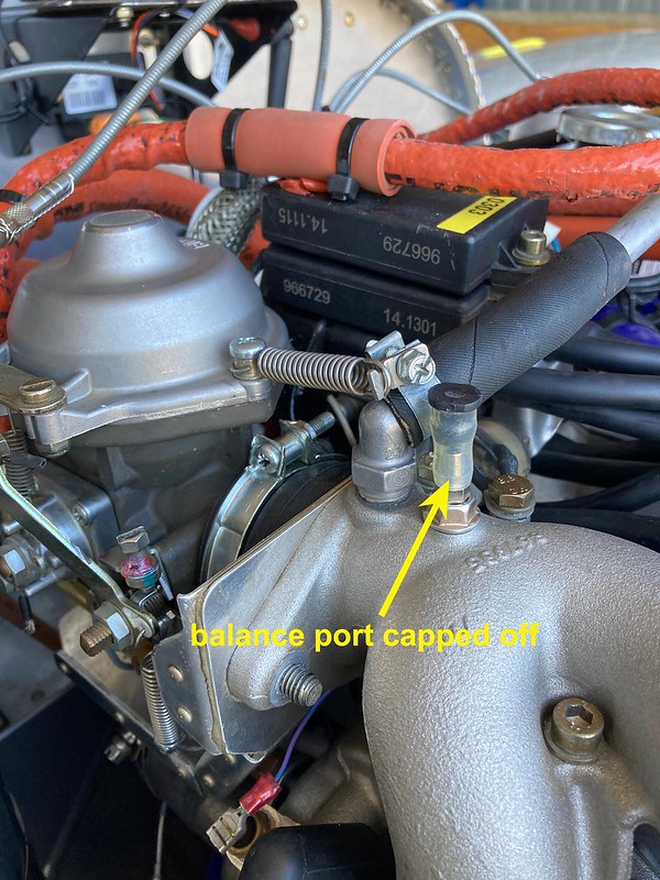

I drilled & tapped (2) 8mm bolts and inserted barbs. These replaced the plugs that are in the intake manifold, see photo. To balance I connect the balancer to these left and right ports and clamp off the balance tube. I have silicone plugs that cap off the ports when I am not using them.
To balance I pinch off the balance tube with these pliers available on Amazon;
search, "GEARWRENCH Small Hose Pinch Off Pliers, 3/4" O.D. Capacity - 3791"

One set of pliers is all that is required since you are only blocking the air from transferring between sides.
