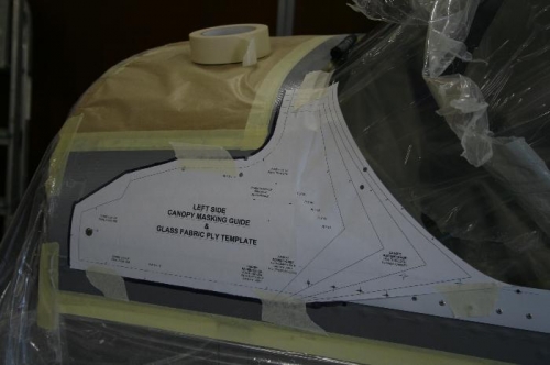

Has anyone had to trim the front edge of the canopy? I've drilled fore, aft and both skirts and clecoed, but it looks like the front edge is hitting when I try to open. Also, where the canopy curves to meet the front deck, it's lower in the corners. Is that addressed when laying up the glass? Or is something wrong?
Thanks, Joe
I had to remove about 1/8" from the forward edge of the canopy. With my canopy the corners were also a bit lower (see wrinkles in paper template). From what I remember I did put on two layers off glass, thereafter some thick slurry with cotton and thereafter completed the fairing with the rest of the layers. Afterwards you can smooth out the depression with micro.
After reading all the horror stories on this forum I was a bit reluctant to start with the fairing but it was an easy job to do. Have fun!
