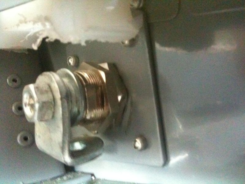

Solution similar to Tom's
I used a similar scheme to Tom's posted above. In my case, I used a triple-bit high-security cam loc which had key retention/release only at 0 and 180 degrees. Tom's lock apparently has a key release at 90 degrees.
I therefore had to mount the lock higher than Tom's in order to rotate 180 degrees for key removal, necessitating chopping up the UHMW block:
The modified tab, and a modified UHMW block for needed clearance, along with the 7/8" depth camloc with added washers and bent catch arm:
[/URL][/IMG]
Parts installed, in open posiiton:
I didn't get a picture in the locked position--the catch arm, if installed without washers, was lined up precisely with the slot and canopy tab, so I had to stack washers and bend the catch arm back to grab the slotted tab in the locked position.
As with Tom's solution, I mounted the cam loc with a backing plate--I used some .062" aluminum in which I hand-filed the double-D hole (lacking a $300 punch), allowing me to drill a normal 3/4" hole in the fuselage skin while having the security of the double-D hole to keep the lock from rotating.
