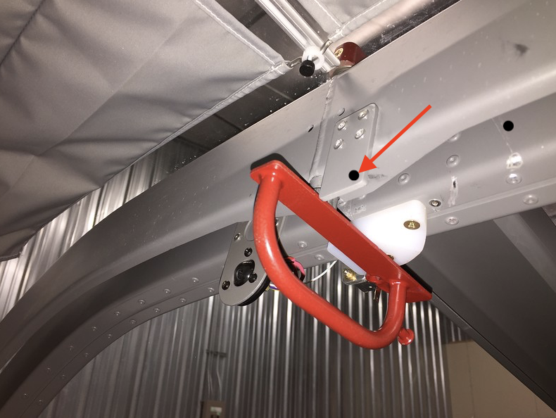

I’ve had a rv8 for years and in the last couple weeks purchased a 12 with less than 100 hrs. I flew it many times with the canopy latch not fully engaged, not realizing it needed to go over the nylon latch. When closed, it looks just like the picture shown. It takes considerable effort to get it closed correctly, and even more, unreasonable amount, to get it back out of the nylon piece to open. It takes both hands to unlatch. My question, is this right and how or what can be done to loosen up or make this easier? The canopy latched is one safety issue, but getting out could be another. Any thoughts would be appreciated. Thanks
Check under the nylon latch block for shim plates. If there are shim plates, remove them one at a time to reduce the latching force.

As mentioned, if the block is shimmed too much below the roll bar it will make it difficult to latch / unlatch.
If that is not the cause, the unlatching resistance can be adjusted if needed, by adding a slight bevel to the step in the block by trimming the sharp edge using a razor blade.
Do a very small amount at a time. When properly adjusted, you should be able to open it with one hand but it should still have some resistance that you have to overcome to rotate the handle past the step.

My recommendation isn't to shave the block thinner at the detente step. It is to use a blade and cut a 45 degree bevel so that the edge of the step isn't so sharp.
The reason the handle can be hard to open is because the sharp edge of the handle gets caught on the sharp corner of the step. If you relieve the sharpness of the step slightly it can have a major influence on how difficult it is to open.
A better idea is to upgrade to the new handle / latch design

The new canopy latch design locks the canopy in the open position so that the canopy can not open more than a few inches. Somewhere in these forums is a link to a video showing the wind catching an open canopy and slamming it against the propeller. After watching that video, you will want to order the new canopy latch.
The legacy latch has an add-on catch available that will prevent a propped open canopy from being blown open.
A photo of the new latch design can be viewed HERE

As Scott and others have said, it is possible to adjust the latch you have but even after having done that mine was still too difficult to get open in a possible emergency. I used to carry a short piece of plastic pipe for leverage just in case. Since then I have installed the new latch kit and can answer your question regarding making that change on an older canopy.
First there is a distinction between the latch and the catch. Your questions are regarding the latch. The catch came later to help prevent the canopy from being blown open when the handle was unlatched and resting up on the roll bar.
This is the legacy latch and catch like you have. You might not have the catch as it came a bit later than 2013, I think.
Here are a couple more pics of the new latch and catch. The parts to retro fit this upgrade are available as a kit from Van's for $125 and the reference is notification N17-12-08; a 14 page set of instructions to install the kit.
To install this upgrade, I would describe the level of difficulty as at least a 7 or 8 on a scale of 10. Maybe less if you are an experienced builder with all the tools, more if you have not built anything similar.
