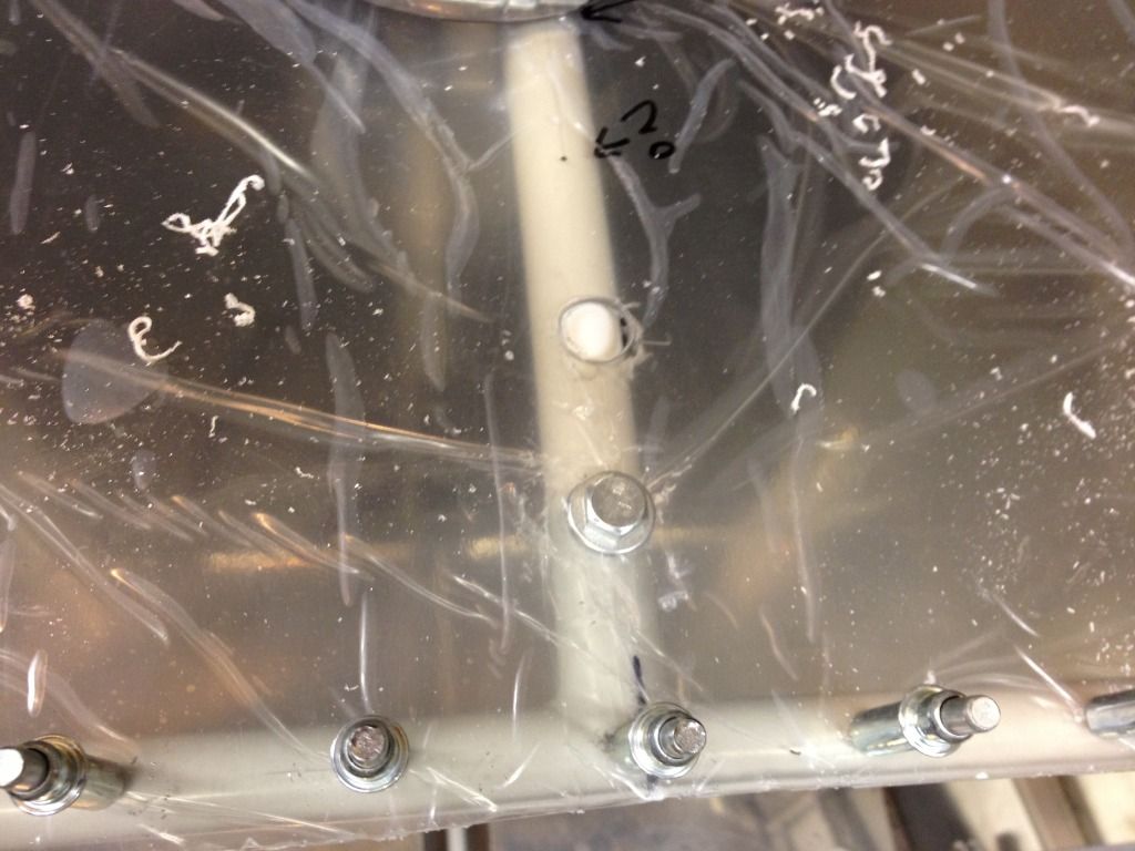

I have a free canopy hole I am offering. You have to pay shipping from Texas. As you can see I have two and clearly only need one. If you are in need of a hole and you have not made your yet then this one will work perfect. There is one caveat: It ONLY fits the RV7 slider.

I hate to say it, but it looks just like the one I own already. i plan to stika my canopy and will fill the hole (the frame will cover the inside) and put a nice looking plate on the outside that will also serve to protect the area under the latch handle.
The plans call for a cover strip on the top exterior that should just cover that hole. I would plan on doing something to try to plug it, maybe cut a circle from some scrap canopy material and sika it in place? If you're careful with it only you (and the entire Vans Air Force now!!) will know it's there when you're done! :D

What's wierd is I actually didn't get that upset. Maybe because it's right in line with the other one and I'm going to cover it with an aluminum strip. I thought about cutting out a roung plug out of spare plexi. Mix that and some proseal, cover with aluminum and voila! Two holes but only one drips water!! Maybe one day I'll get an itch and replace it but for now...

We still haven't heard the story of how the extra hole came into being - time to 'fess up!

Oh well that's real simple. Canopy frame didn't fit real well in canopy anywhere. Slide fwd and back spine doesn't touch. Slide back and the fwd canopy frame that touches the roll bar doesn't touch. Call Vans and they say "Split the difference". So that's what I did. Cut the thing, drilled the hole. Flip it over and put it back on the frame on the RV and there was half an inch space on the fwd frame. Ohhhhh, that's not gonna work... Called Vans back. This time I got "Don't worry about the spine, fit the front and back". Well HOLY SMOKES!! I initally was told to go for a "general fit". This did not work. They broke down and told me I did not HAVE to rivet the spine, or I could rivet the the part that touches (the front). It's not really their fault. I kinda blame the canopy people, engineer who made the instructions, Partain for bringing me the kit, Anne for taking my order... I'm probably leaving someone out but I will blame them later. :D
FWIW - I drilled an extra hole in my canopy also. I fit the spline perfectly with the canopy upside down on the table, but didn't clamp the sides of the canopy to the frame during the fit. This changes the profile of the spline curve considerably and the result was the hole about 2-3" too far back.
My Fix - I put a piece of packing tape across the hole and filled it with West Systems Epoxy. The epoxy cures slightly yellower than the canopy, but it seems less obtrusive than the darker sika or proseal option. You can't see the hole from the outside due to the cap strip, but it's easily visible from inside the cockpit. The epoxy has held solid for 4 years and 800hrs.
