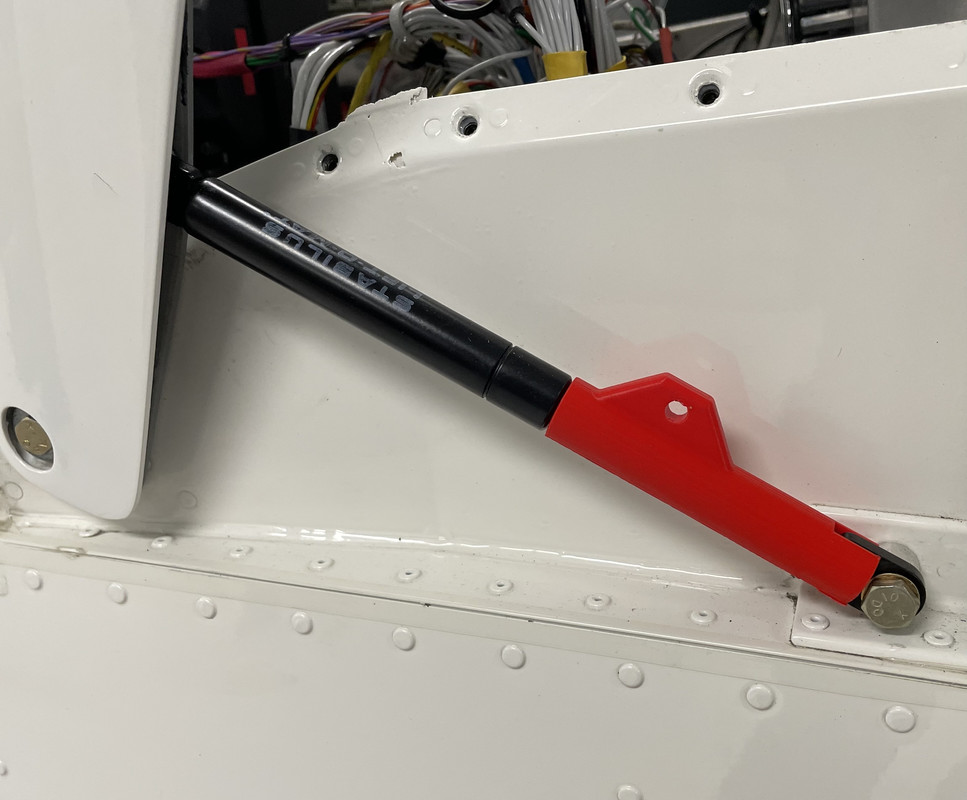

My canopy got hit by a gust of wind and it shut without guidance. The pilot side latch was damaged, but repairable. Has anyone come up with a good solution to keep the canopy in the open position? Thanks in advance!
I have a 6, not a 12, but I put a piece of PEX slit long ways (~8" long) snapped over the piston part of one of the struts anytime my canopy is open and I'm more than 1' away.
Harder to reach on the 12, but might still be doable.
I used some schedule 40 PVC pipe to make a stop that fits around the strut shaft. I do not have a photo of it installed on the strut, but I did find the prototype to give you an idea of what it looks like. The slot in the end fits around the flat part of the strut shaft to keep the PVC from rotating. The long slot along the length fits over the shaft and butts against the gas cylinder end. I used a heat gun to soften the PVC and wrap it around a wood dowel to get the correct diameter. An oscillating saw is handy for cutting the slots.
Installing is simply putting the thru-slot end on the flat shaft mounting end and rotating the long slot over the shaft. I trimmed mine for a snug fit. You can install and remove it while seated in the pilot's seat. If you use one on each side, the canopy will not move.

I use a similar slotted tube, but aluminum. I also made 1/8” cable lanyard with a caribiner at one end and a key ring at the other to parent blowing forward. I installed an AN eyebolt in the crash arch manufacturing hole. The key ring fastens to the eyebolt hole, and the caribiner clips on to the canopy handle. The cable is about 1/2” shorter than full open so the air spring attachments never gets stressed if the canopy is caught in the wind.
I split a length of rubber hose. Slips over the rod part and is easy to pop on or off. One for each side.

I decided to upgrade my PVC pipe version of a canopy strut lock to 3D printed item. 3D printed version has a much better fit and I added a key ring tab to attach a Remove Before Flight flag.
The printable STL file will be available on Thingverse.com and Printabales.com shortly, along with some other RV-12 3D parts I created.

Dave,
The part was designed with Fusion 360, so no .dwg files is available. The lock is 81mm long and the slot is 6.5mm wide. The gas cylinder on the RV-12 has a shaft length of 71mm from the gas cylinder end to the weld at the 6mm round shaft to 5.5mmx11mm rectangular mounting flange. The photo shows the bottom side of the lock, the small expanded area is to clear weld bulge at the round shaft to flange weld.
If you have some dimensions from the RV6 gas strut I would be happy to make a quick modification and publish an RV6 specific .stl file you can use.
