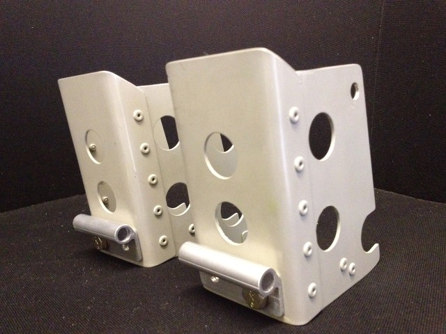

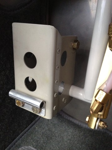

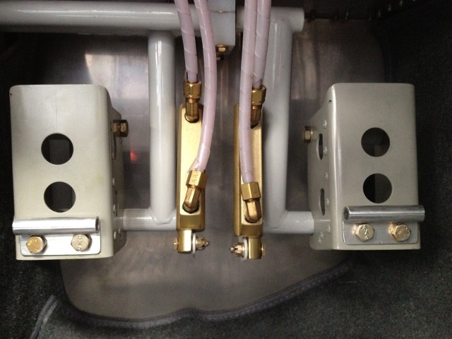

We've since modded the seat back support pictured in post #2 and appear to have made some workable bolt-on rudder pedal extensions.
Just back from OSH, give me a day or so and I'll post some more pictures.

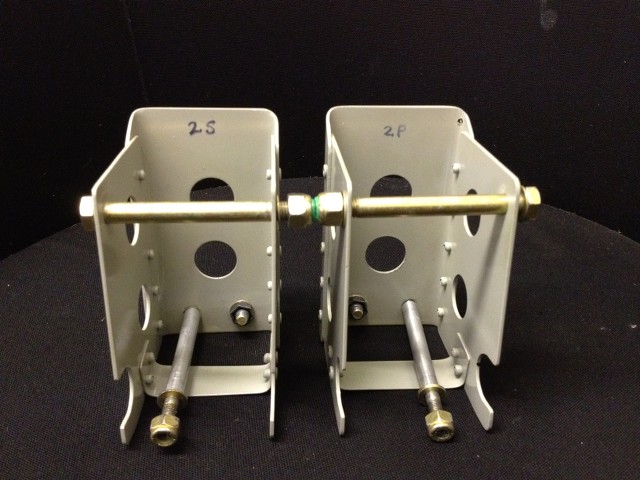

Here below is an idea we have worked on and are awaiting approval for from the UK LAA who oversee non-certified aircraft here. Credits for the design go to one of my co-owners.
I have a drawing showing dimensions but it's a Word document, so doesn't post well here - if anyone wants a copy let me know. Not up to the Van's plans standard, mind!
I have sent the info to Van's in case they are interested in producing them as an option....

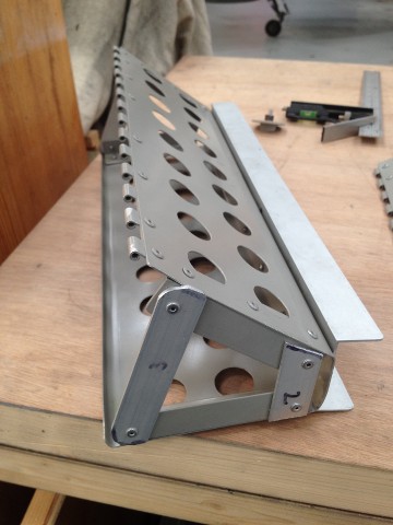

Here is 'work in progress' on an extended seat back brace. Final fit (lower pic) has more angle at mid span for added strength. Velcro straps stop brace slipping off the cross beam when you don't want it to.
