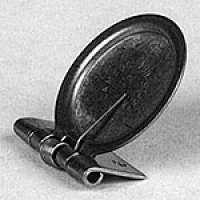

I'm wondering if anybody has fitted the Camloc access doors shown below on their RV-12 wheel pants to facilitate easier tire pressure monitoring? If so, are you pleased with the product? Any pitfalls or instillation tips pertaining to the RV-12?
I've been thinking of polishing up a set and installing them on my RV-12 ... knowing somebody else has installed them successfully would be encouraging.

I have those installed on my wheel pants. 13yrs and over 2000hrs. Would I do it again? Definitely not, unless you're just looking for little things to fiddle with.
The reality of use means using a fitting extension, ok, no big deal, works fine. Then you need to mark the tire/wheel assembly to attempt a reasonable line-up, doable, but not perfect. You certainly can't see the stem that you are trying to stab with your extension through the hole... Nah, just a recipe for a few minutes of frustration.
I choose to just remove the front half of the wheel pant, take a good look around at the whole rolling assembly, and add air if needed. No frustration and much added inspection benefit.
Just my 2c.
+1 to Scott. I would not do it again. If I get hard up for something to do some day I may even remove them, glass over the hole and repaint.

Hi John, glad you asked the question, I was also wondering about those camloc doors for my RV-12. Sounds like that are more trouble than they're worth. I think I'm going to try the motorcycle bluetooth tpms system. There is one by a company called FOBO, that is specifically for a trike, so you get 3 monitors. I don't mind taking off the pants when I am sure the tires need air, but it would be great to know for sure before going through the hassle. Ha, just realized from my sig....today is 3rd anniversary of my first flight. I digress :)
+1 to Scott. Looks nice but inflating the tires this way is not a pleasant experience. A bigger access door would be nice or also +1 for the Cessna doors

Thanks for all the valuable input guys. Guess I will pass on the Camloc access door.
I was hoping for a better way to monitor tire pressure because in addition to wheel pants, I also added intersection fairings ... so have many more screws to remove to get the wheel pants off to access the air valve. Of course, as has been mentioned, it is good to remove the pants occasionally anyway for a thorough investigation of the gear components.
Paul ... I like your idea about using the bluetooth FOBO trike tire monitors. I looked those up and the set of three costs $148 ... only $25 more than a set of three Camloc access doors. My only reservations is the size of the monitors .... the specifications show them to be .8" in diameter which means they will require .4 inches clearance from the center of the valve stem to the wheel not to mention the additional 1/8" clearance suggested by the manufacturer. This is not an issue for the RV-12's Matco nose wheel, because the valve stem extends beyond the wheel. However, the valve stems on the Matco main gear wheels do not extend beyond the wheel ... they stop well short. Looking at photos on my blog, it appears the valve stems are positioned very close to the wheels (I'm think around 1/2"). It's close ... but I don't think there is .4" + an additional 1/8" clearance between the center of the valve stem and the wheel.
