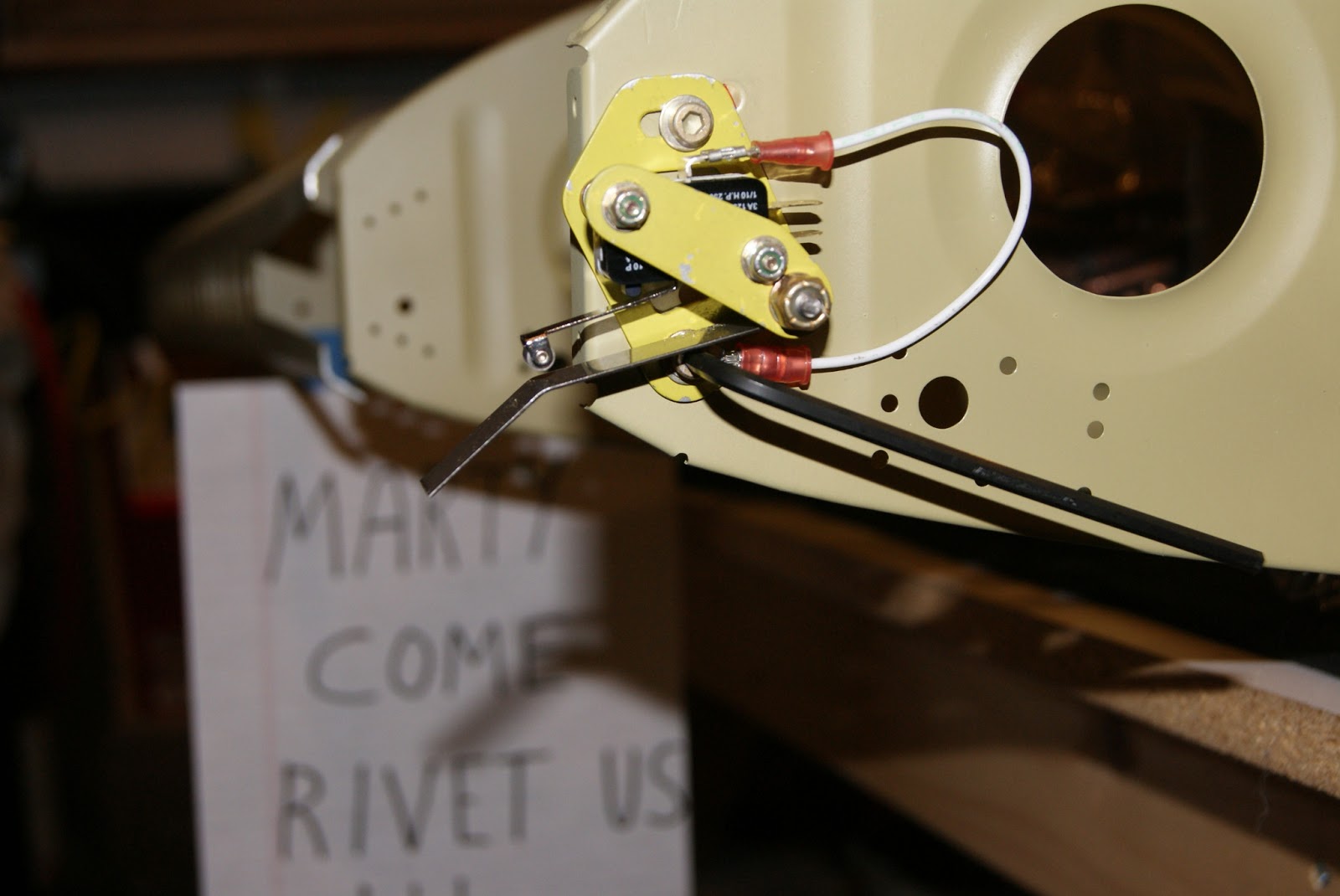

Allen socket screws for stall warning switch
I?m building E-AB and one of the wing modifications I made was replacing the two Philips screws used for mounting/adjusting the stall warning micro switch assembly with 9/64? Allen socket head screws. I feel it will be much better for making the adjustments when the hand is in such cramped quarters without the worry of stripping Philips screws.
