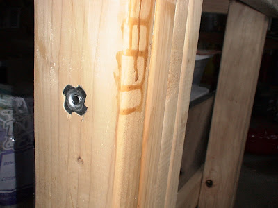

I built two just like the EAA 1000 plans. Then I modified them with castors, an inset back rivet plate and T-nuts with long bolts so I can bolt them together as a single 4x5 or 2x10 table. So far, I wouldn't change a thing through the wings.

Big John's tables and am happy with the result. You get three tables from one sheet of plywood. Each of the tables is 48" by 32" and I can bolt them together either as 144" by 32" for the 'long' item construction or 96" by 48" for the fuselage, etc. Works great.
After seeing some 12 builders say that they wished that they had the ability to raise or lower their work benches, I incorporated an adjustable height feature. That was a lot of extra work and probably not worth it.
