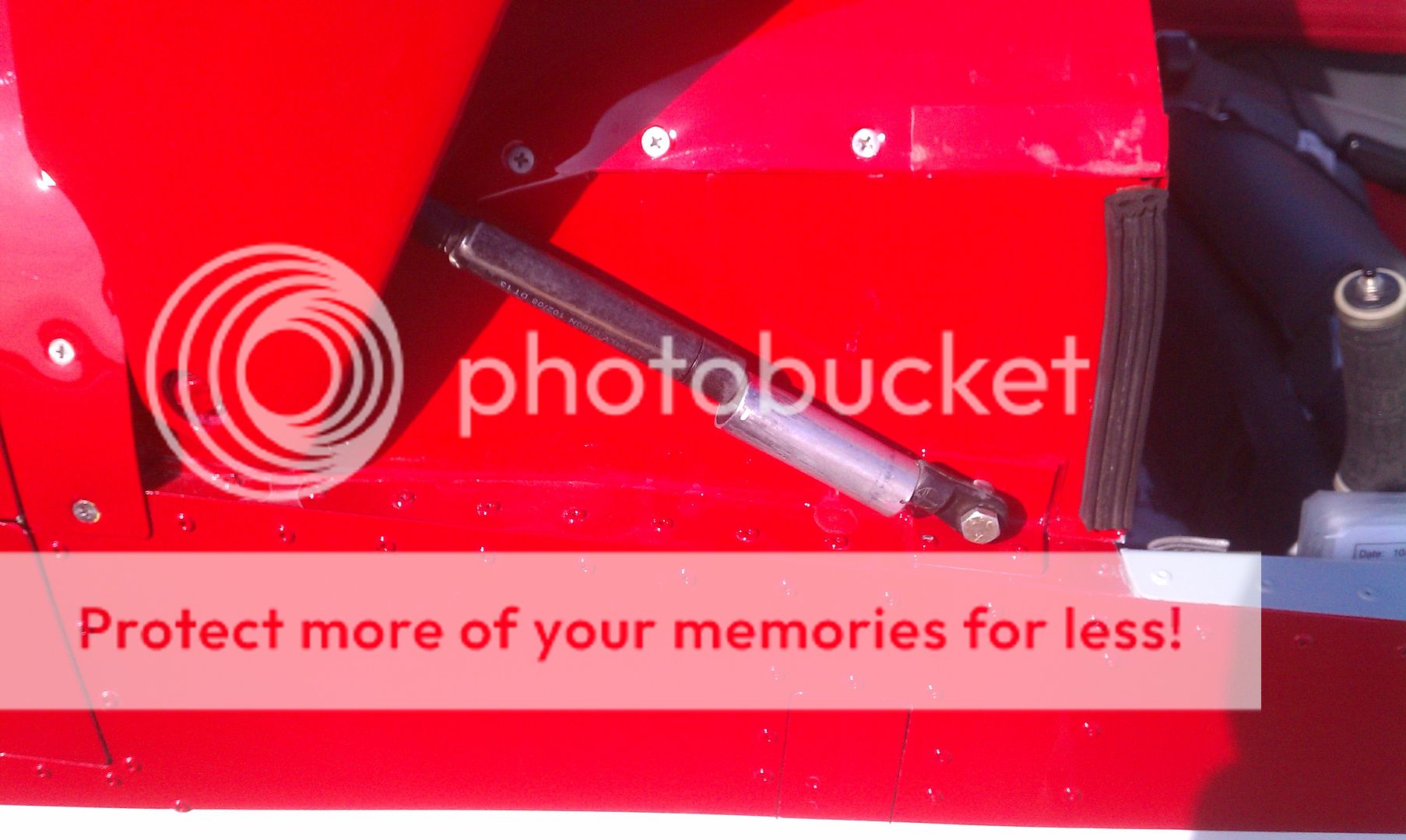

I have had three fail in the first 11 months I've owned the airplane. The plastic rod ends fall apart. Van's sells replacements for $20 each but I'd pay about five times that for a strut with metal rod ends that won't break.
Because my airplane is "certified" I can't just go to NAPA and buy replacements.
If you have any input I'd love to hear it.

What is Vans saying about this? It should be covered under the warranty right?
Are they aware of a problem and are they looking at a better option?
BTW with fingers crossed I've not had a problem in this area.
The problem seemed to surface after we had to drill out the end of the strut to a larger hole when doing the pivot strengthening bulletin.

If it is an SLSA, you MUST use parts supplied by Vans unless you can get written approval to use an alternate part.
To keep the canopy from blowing DOWN in the wind:
Get a piece of 1/2 inch PVC pipe a few inches long (measure).
(CPVC may be better because of the smaller OD.)
Cut a slot down the side the long way - just wide enough to let the inner rod of the gas strut slip through.
Raise the canopy all the way and slip this on the rod where the wind cannot compress the gas strut anymore. (Park facing into the wind.)
You can make a pair of them if you think necessary.

And I had one end of a strut break so made one out of aluminium round bar
As I remember it was not a notification or service bulletin. Someone posted a message on this forum indicating they noticed a plans revision and a new part number for the bushing. The new bushing minimizes flexing of the attach bolt. I installed it, and, it helps.
Find the page for the installation of the strut, then find the new page in the revisions.
Found it..... http://www.vansairforce.com/community/showthread.php?t=97766&highlight=canopy+strut

Like this sort of!;)
That was it Marty, thanks for the help.
