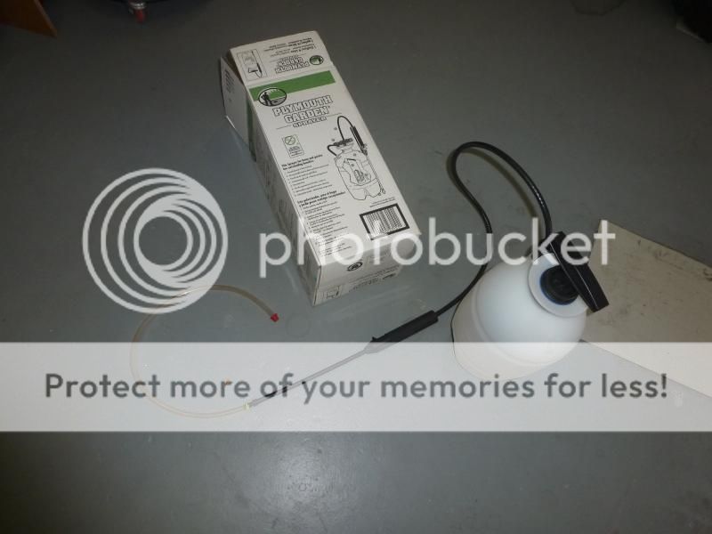

OK, WalMart aviation department furnished me with this brake bleeder, will try this system now.
[/IMG]
Well high pressure and high flow rate did nothing at all. The same thing happens, this bubble will "bleed" down into the master cylinder, go into the master cylinder, but never out the top, until you close the bleeder and pump the brake pedal, then it returns to this position.:mad:

My 'POWER' Bleeder - -
Simple, but works. You need the bleeder open at least one turn, pump it up fairly well. Turn on flow, and watch fluid move thru system. As it gets to the first master, move the master back and forth quickly, and slightly pump it until you see no more bubbles. Then stop flow. Go to other side and start it again and see if bubbles in second master. You should see all bubbles move on thru. Maybe you are not getting enough flow. OPEN ONE TURN.
Thanks, that was going to be my next attempt as well. Between the pressure on the bleeder pushing it one way, and the master pushing it the other, surely I can find some fitting to crack a bit.
John I have the bleeder open fully, plenty of pressure blasting, but no joy. I ran a full drinking glass thru it this morning, and still have bubbles from both left brake masters. Strangely though the right brakes seem to be completely free of air, very solid pedal too. Could be a sign the left side has become possessed by demons:D
