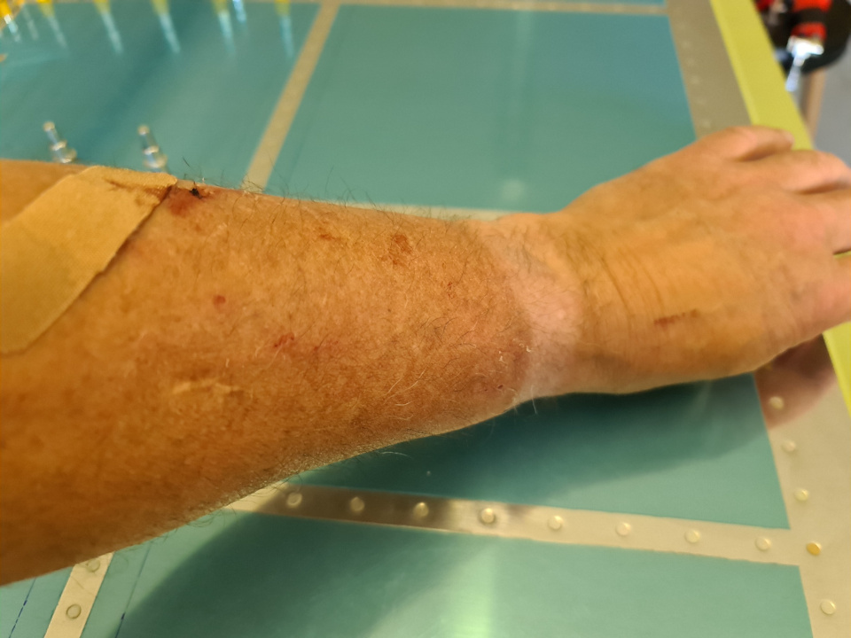

I just finished the bottom skins. Had someone help with the first inner then solo for the other inner and both outer bottoms. I'm 6'4" with an 6'8" arm length and I still needed my wife to help with 5 rivets in the outer bottoms that I couldn't reach when they were completely closed. Any setup up that will pull the skins away from the wing will help minimize the bruising on your arms and help with the reach.

No pain, no gain
Well quoted. Think of it as a "right of passage".
