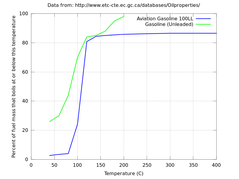

gasoline vapor pressure
This diagram might help you.
Can't vouch for its accuracy, but looks reasonable.

Mickey, thanks a lot for that chart...that provides a nice visual depiction.

I probably posted this in another thread, but it might be interesting to some. Sorry about the poor quality - it is a scan of a fax!
UvsDpA4zSHjuLALSWbETj9UwdrN1BL-G-oDp-cxh897U2k6Xz_lpL1Bn2ZSt6swYRs_IVouE7p1-7yx77TCUxUD1NKadhj5Cj9rhrQ0ofTi5aalZ9v6tY0UGLMchnjH_jtiZO1dD82QPMt42-X1aJwF_huSrXOsvpKXpgmZucH-7GILIstfex8Vhi3VZ1g_RrGVxBOgYZlGur7AXpsNBr6jirYXbyaJ4PrXGM1XhjCtiehK6vSvsId_sGQzLLpWUp722X6zTeDA9yXqTCGPB7TkdSO4pkHZi_x5hN1w8_YACc_8wtq_XIEKQgUeTjY7DpivFL5EAfJs-1OGVtX8pbAYesOP3BZgU8umKtDjrEA0r7cZFIoTK0Q1JU26McxwJoMHN29JmPuONMW1StPBjvDl0S38z3wZaCw1nxf1r2Abd1WXtb3a25My1p7mFmhibVjeXazCV9p5Ehvq1-QL7A0G9dp4FBsEMJJ7FZx563g1QOouCzkgVJ0QTYVPZ8vfSNkZ9EIIWockt5GkEKrtIcD5PCbhbG77QwOTxyiTNrpHDd9NO6KtX4vxQZXUWKy-kh2DuiwpXza3g-R8sxPt1XTHYA13H2RitDEK-zhBlcpkVyqCR5wy_KCAkS1ky5y2nBhvTN3J0Qmo2eH5t38GXoE4ezw=w713-h978-no
As an example, at 40C, it takes about 45 KPa of pressure absolute (~110F, 6.5 psi) to prevent avgas from boiling (it is the top curve). At idle, a standard aviation fuel injection system might only be delivering a couple psi gauge downstream of the servo, so perhaps a total of 17 psi absolute if at sea level. This corresponds to about 60C or 140F. After landing, when little air is flowing through the cowl, it is easy to imagine the lines downstream of the servo can exceed this temperature, causing percolation of fuel into the cylinders. The classic barfing and puking that some injected engines do at hot idle.
