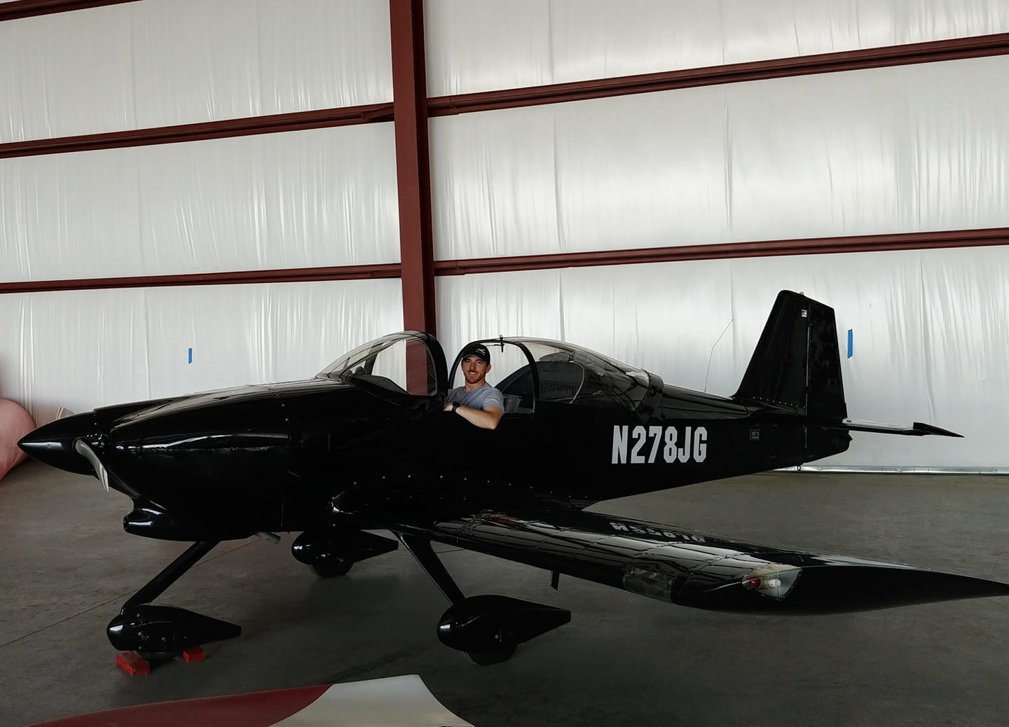

An A&P advised me that black paint will cause my fiberglass to go past its Tg and distort. I have used black paint on boats, and see other RVs with black paint so I thought I might find someone here who has done this and can share experience with hot sun conditions.
As a mental aside: wouldn't shutting down a fully warmed engine with the stock Van's baffling provide more temp than sun/black paint? (of course I am talking about the average core temperature of the glass matrix and not what we feel on the outer skin)

My RV4 was painted black. I owned it for three years, and the next owner had it for many more. While I had the plane I experienced no problems. I do live in southern Canada. If I was in Arizona I might consider another colour option. Also if the plane was tied down outside I would not paint it black. Consider the number of actual outside hours a year your plane sees if it normally rests in a hangar.
I hear lots of bad things about black paint on airplanes but is never from some one who has actually owned on.
Numerous pilots told me that it was the easiest plane to spot in the sky.

My RV-4 is black on top and on the leading edges. The fiberglass doesn't seem to care.
HOWEVER, it is shocking to see the leading edge ALUMINUM parts distort after a descent from cold altitude to a hot sunny ramp. I just about soiled myself the first time it happened. But as soon as the spar warmed up and grew to the same dims as the skins... gone.
