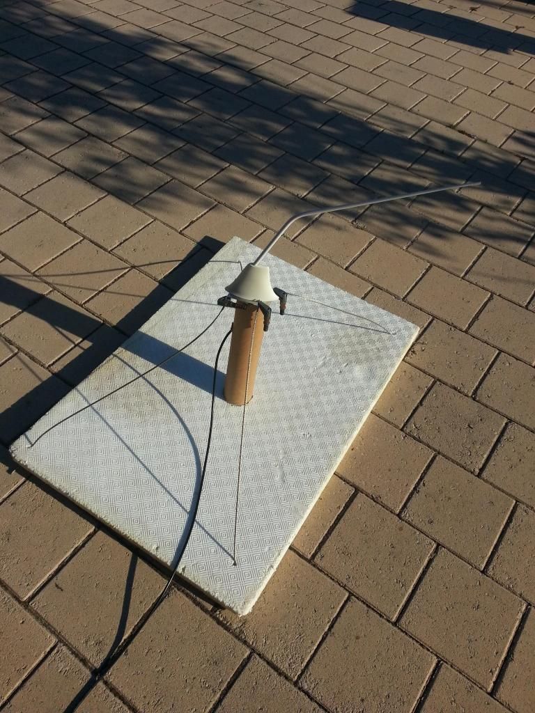

I have a Delta pop, bent antenna for VHF mounted on the belly of my RV6 just before the spar.
I am interested in what the best SWR you have achieved in that location.
I was able to get the following SWR on a test rig at home (bench testing)
118.0 1.39
127.0 1.09
136.0 1.41
I am unable to get the same results on the belly of aircraft approx 1.8 SWR
I have been advised that belly mounted VHF is not acceptable and would always have issues.
*All my testing was done in open area away from any buildings/hangars.
*Ground plane is connected to antenna mounting screws and checked with ohm meter.
*Same coax used in both tests (Dummy load used to confirm coax is not at fault)

Well this is my DIY testing rig made to confirm the antenna itself was able to achieve a good SWR (Trimmed it about 10mm to get SWR of 1.05 at 118.0 to 1.4 @ 127.0)
The radio is a MGL V6 and the supplier is working very closely with me to resolve the problem (Support has been excellent) but I didn't want to set myself an unachievble goal if SWR of 1.8 was acceptable, hence asking the question to you guys.
I am going to experiment with the antenna on the aircraft and see if I can resolve the problem.
BTW: I used cheap Coax on the rig not to waste money..... RG400 used in the aircraft.

The ground plane is made up of 4 steel wires (550mm long) connected to a piece of aluminium the antenna is mounted to at the base.
Better match on the test rig -
It's because you have drooped your radials away from the radiator, getting closer to 50 ohms impedance for your quarter-wave monopole antenna. As you dress the radials further away fom the radiating element so the they look more and more like the other half of a dipole (180 degrees between the two poles) your feed point impedance will go from 36 to 72 ohms. At a VSWR of 1.0:1, you've found the droop angle where it's 50 ohms. Not so easy to do using the belly of your monocoque fuselage as your ground plane, since the "droop angle" is fixed by Van himself :rolleyes:
If you find a spot on the belly where the installation gives 50 ohms and 1:1, it was luck, and time to grab a beer.
-Stormy

Posting my results
As the author of this thread, I thought it would be appropriate to post my end results for future readers.
I have removed the entire radio, coax and antenna for testing then re installed it with the same coax and antenna and it now works so clear on the unicom frequency I had problems with before, I have not tested the entire band but it is already sounding soooo great and not sure what the issue was.
Currently my SWR is still between 1.8 and 2.2 with good RX and TX with power output of 5-6 watts (So SWR was not the cause)
I did find a badly bent female centre pin coax connection on the back of the radio which could have caused it, although a dummy load showed swr 1.02
Adjusted my mic setting on my headset to minimum
I have got a radio check in the air from 30nm away 5x5. I am glad the problem is resolved but bit disappointed that i couldn't pinpoint the fault....and that I cut my antenna :(
