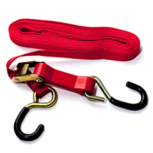

Don't Even Consider That!
Oh dear God.
Please - NEVER use an open hook for tie downs. The hooks can jump out of the tiedown ring and they can open up. I've seen it.
As for knots, the knot needs to be snug to the tiedown ring so that there's zero possibility of it slipping. Zero as in none.
When conditions get severe, airplanes start bouncing around and that's when things fail. Keep your ropes tight, my friends.

No need to get God involved here. However you make a good point in severe conditions, if your sky scooter moves or develops slack the hook could slip off. The biggest issue I see are cheap inadequate tiedown stakes or anchors. Another down side of these tiedown straps is weight. If you and your Pax are flying around with camping gear, you need to save weight. Rope is way lighter, will weigh less.
Truth is a really strong wind, thunderstorm, frontal system or other severe weather, you risk you plane out on soft ground with tiedown stakes in dirt. I find marine grade nylon rope to be best, and don't go too crazy with diameter. The weak link is likely the stake in the ground not the rope or strap.
